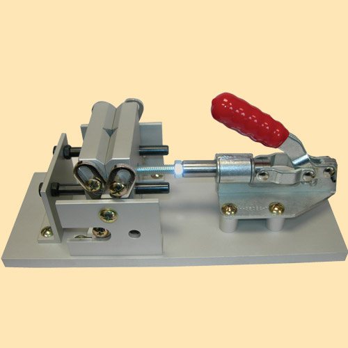

If you have a Woodcraft store nearby, check out the new one they have from General International. It's pretty heavy duty and about the same price as the Rockler.
General International Vice looks pretty good...here's a pic from the website:
I picked up the less expensive model from WC. I'm happy with it. Used a couple of C clamps to hold it to the base of the drill press. So far it works well. but,, I'm just beginning.
I've got the Rockler press/vise and it seems to work ok. Once I clamped it to my drill press table, I've never had to move it despite running variously sized blanks through it as the self centering feature works fine.

My only long term concern is that the threads pass through some plastic bushings that have a groove cut into them that slips into a thin metal bracket. I suspect that either the bushing or the bracket will eventually fail.
I have the Rockler press/vise also. I did experience one problem with it. After making about 10 pens over the course of 2 weeks I was cleaning my drill press and found 3 ball bearings on the the table and floor. Thinking I had something coming apart on the DP I grabed my sweeper magnet and quickly found 3 set screws and 3 springs. Then I realized they were to small for the DP. Then I noticed empty holes in the pen vise. There are two set screws on each jaw of the vise with a spring and a ball bearing under the set screw. I am presuming that they take some side to side slop out of the jaws. Unfortunatley I only found 3 out of 4. I took it back to the Rockler here in Detroit and the guys there swapped me for abrand new one with no hassle. The moral to this story is if you buy one check those set screws or do what I did and put a dab of threadlock on the set screw.
Other than that it works just fine

We have one of those in my FIL's shop. It seems to not clamp the blank perfectly vertical.
I finally got around to trying out the 'deluxe' one yesterday. It worked very well, but it could be a bit of a hassle if you are often changing between blanks of different sizes because you have to keep fiddling with the adjustment bolt.

I have the Rockler Drill Press vise and I am having problems. After having it only a couple of months, when setting a blank either round or square, the vise will open at the top when tightened allowing the blank to wobble closest to the drill bit. This in tern makes the hole bigger then desired. Does anyone know of any adjustments?
UPDATE!!! Just talked to Rockler. The have not had this problem before to his knowladge. Because it was within a year they are sending out a replacement. Great Customer Service!!!

I have one of the Rockler Pen vise/clamps and while it is fairly well made, it has it's limitations. First of all, I switched over to drilling my blanks on the lathe for accuracy since I wasn't getting what I wanted on the drill press. Secondly, this vise can be somewhat difficult to assemble pens with. There are many times that I really have to put some muscle into pressing the pens and almost as much to release the vise. I'm talking full arm strength just to turn the crank handle. I may not be Charles Atlas, but I am fairly strong and this vise is not the easiest way to assemble pens. I am on Paul's list for a new Pen Vise and can't wait to get it. The only thing I use the Rockler vise for is to hold the blanks while I use the pen mill to square up the ends. Just one person's opinion...
