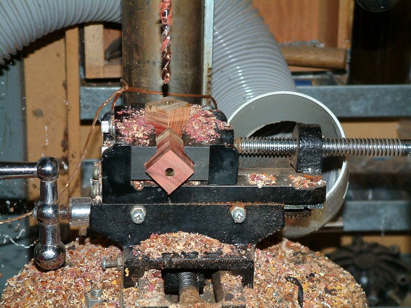

I use an X-Y axis movement vice fitted with prismatic jaws served me handsomely for twenty years of thousands of blanks. I can drill crazy cut blanks and so forth I switch the drill on and drill sometimes hundreds always using DeWalt drill point drills that give me many hundreds of uses cheap as chips overall.I have drilled at a session many hunderds of 1/2 inch Corian, took me a day to tune the gibbs etc for firmness and squaring up the vice and drill movements.
Peter.

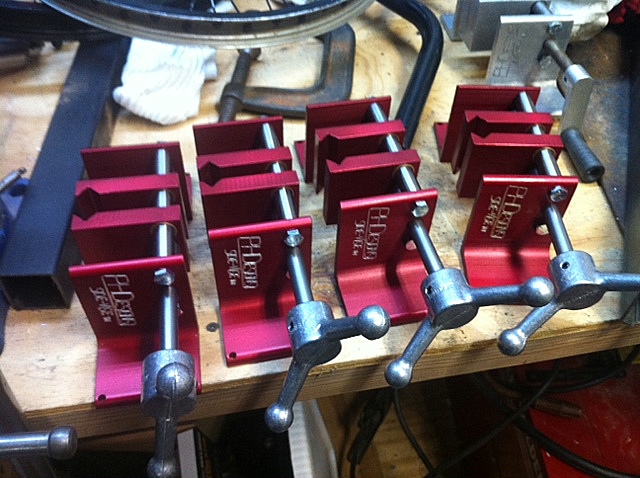

Paul makes those and sells them. There are a number of people on IAP that bought them from him and are extremely happy with them. You may want to PM him for information.
Note: I do not own one and am not promoting these for him. Just repeating what I have read on here.
