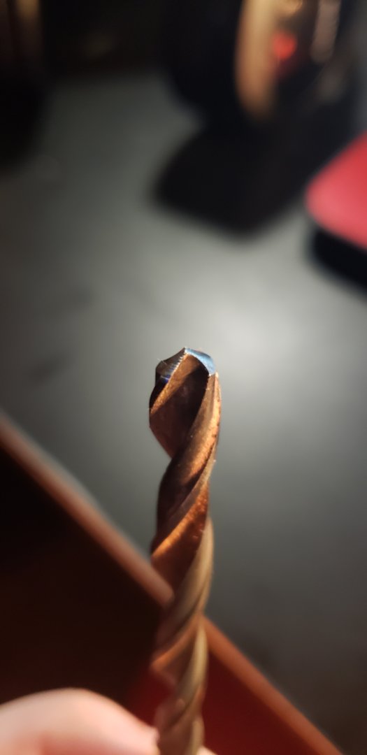

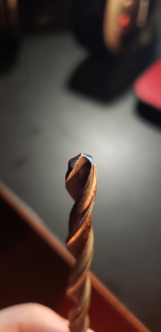

Here is what the bit looks like. I dont know how to answer your other questions. Sorry I'm not really familiar with a lot of this.

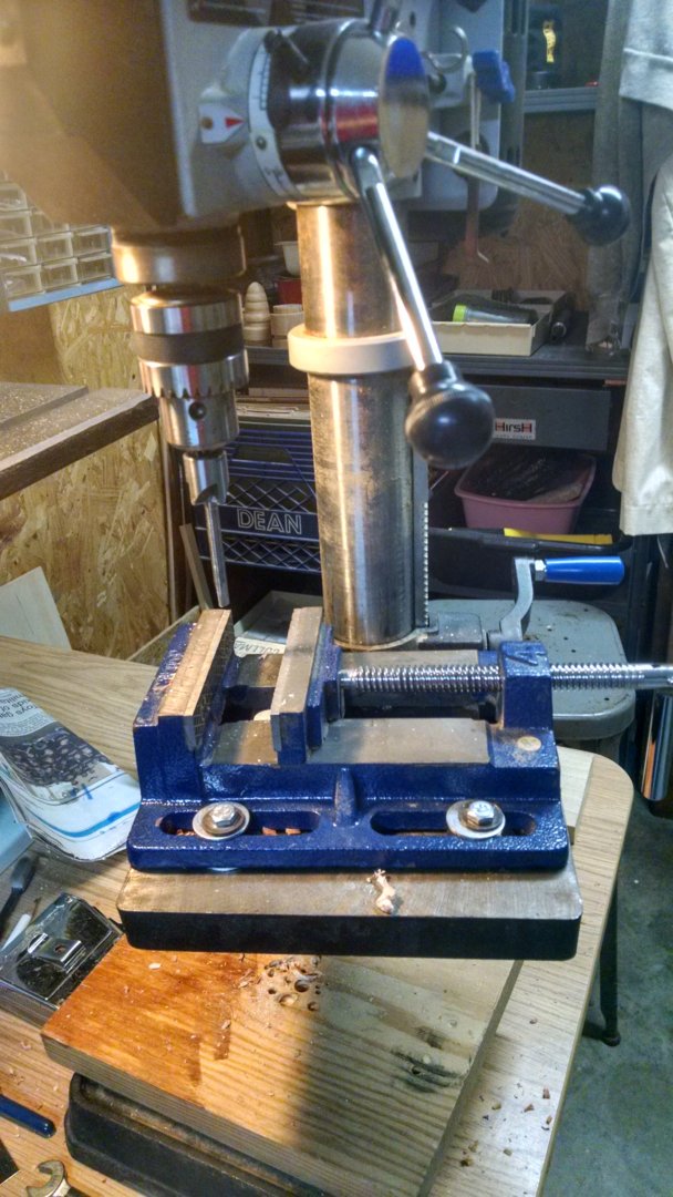

Good advise to use as a check list. I tried to drill on the lathe but, to me, it took too long if I'm turning more than one style. Here is my setup. Had to put washers under one side of the vise. My son made a triangle
gauge to square the bit to the bed of the vise. Said it was accurate to a couple of thousandths.
Most of the tables I have seen on the table top drill presses tend to flex downward when you start drilling and add pressure. That will cause the problems you described.
Good advise to use as a check list. I tried to drill on the lathe but, to me, it took too long if I'm turning more than one style. Here is my setup. Had to put washers under one side of the vise. My son made a triangle View attachment 222500gauge to square the bit to the bed of the vise. Said it was accurate to a couple of thousandths.
That is actually kind of how mine looks lol but my vise is drilled into a piece of wood what is yours drilled into?
No just dust from the wood
That does not look like it is "all" dust on the outside. A sharp bit should be shiny on the leading edge of the flute as well as fairly sharp too, excerpt on some specialty bits. If it is sawdust, sawdust build up that doesn't fall off - is usually there because of resin - ( and that creates too much friction) which can really cause problems such as smoking and squeaking as you mentioned. That bit does not look sharp enough to be precise as blank drilling usually requires.
Table saw blades collect resin rather quickly which leads to smoking and inaccurate cuts. Drill bits can have the same problem.
It was there cause I just finished trying something out with the bit not 5mins before I took the picture. But I will try and buy a new one soon

I thought so to but it drills fine in some pieces of wood but doesnt get anywhere in others
That statement alone is a sign of dullness. A butter knife will cut butter but not a steak. A butter knife will even mash-cut sliced bread or a cake but not cut fish or slice tomatoes.
For about 4 years I sharpened my tools what I called fairly sharp back then. Then I started making segmented blanks with metal spacers in them. I could turn the blanks with the metal without a problem. However, for finishing, when sanding, the sanding would smear the metal dust onto the wood. DNA (denatured alcohol), and other methods would not clean the metal sanding dust off very well.
I suddenly realized that after turning there was no sanding dust, only after sanding. So I set about spending an hour on sharpening my HSS scraper tool to an excessive sharpness. Wow, was I surprised at how smooth the blank was after turning with that kind of sharpness. It did NOT need sanding, baby butt smooth!
. . . the point, there are different degrees of sharpness on chisels and on drill bits. Just because one calls it "sharp" does not mean that it is really "sharp". There are numerous degrees of sharpness among people's opinions and they are not the same. The experienced ones can look at your bit and tell that it is not sharp for what you want.
Different wood have different ratings for hardness. Thats why you are getting some success with a dull bit. Trust me its a night and day difference.
