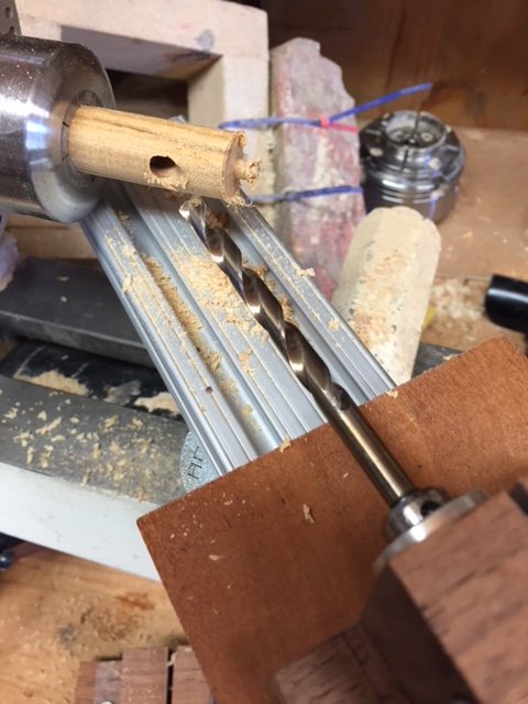

I built one similar to David Reed Smith's tutorial. Drill Guide
I used a 3/8" threaded drill chuck using a bolt with the head cut off as the shaft, with a block of homemade HDPE according to these instructions. https://www.instructables.com/id/HomemadePlastic/ It all mounted on a piece of 1" steel rod.
Cost of rod about 50 cents, bolt less than 10 cents, drill chuck came off a dead electric drill, cost zero, cost of homemade HDPE, zero. My time at a $100 an hour, about 1 hour. Total cost, about $101, total real cost, less than a buck. Value, PRICELESS.

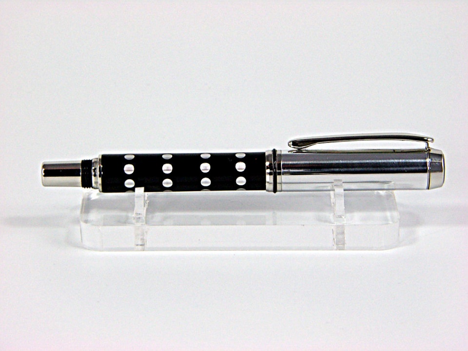

For me no problem with a router. I can drill down to 1/16" Depth can be a restriction. Other than that these pens were done with a router. You can buy extra long length router bits. If I were doing stool legs and things of this nature I would do it on a drill press. May have to make some jigs being I do not have a radial drill press.

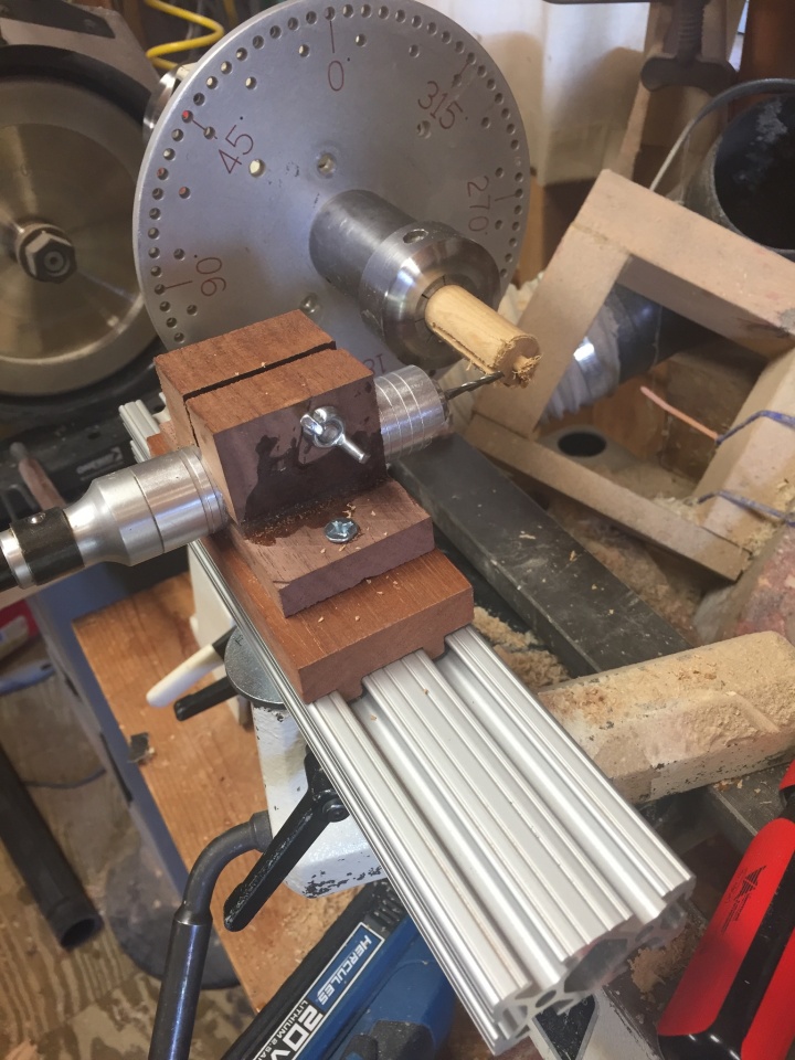

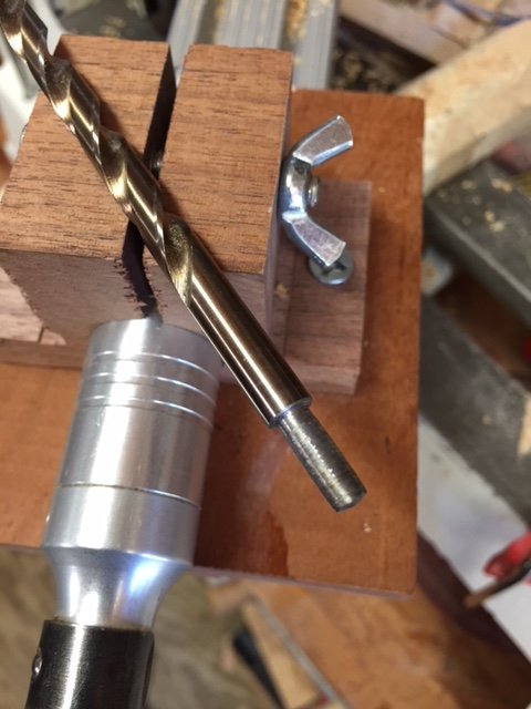

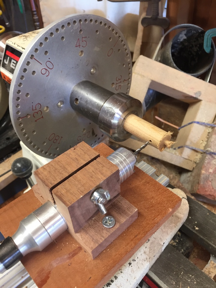

Using this jig
Drill Guide
with one of these on the base. https://www.ebay.com/itm/2-Way-Macr...068106?hash=item3b1a2a928a:g:r0EAAOSwz2lXBx3p
With my built in lathe indexer it makes drilling holes about as easy as it gets. I used a drill chuck off of a dead drill, no cost, a homemade block of HDPE, no cost, a 1" bolt with head cut off for the post to fit my banjo about $1, a 3/8" bolt with the head cut off, about 15 cents. Using my drill that I had, with the macro camera slider, less than $15. I can use any size drill bit up to 1/2" or 1" with a reduced shank.

I used my jig to drill 3/4" holes through the 2" thickness of a 2x2x8 blanks. 4 holes at a 45 degree angle, each hole is then plugged with a maple dowel. then the next hole is drilled and so on through the fourth dowel. All the dowels cross at the same point in the middle of the blank. When turned the dowels look like 8 inlaid ovals. I also had a similar set up that I used on a drill press, but it was the blank that was angled instead of the drill bit.
I sold my first game calls in 1964, my first lathe was an AMT lathe with the 1.125" square tube powered by a washing machine motor. They were sold out of Popular Mechanics ads for about $15. I still have the lathe, along with a few other stuff that I have bought through the years.
