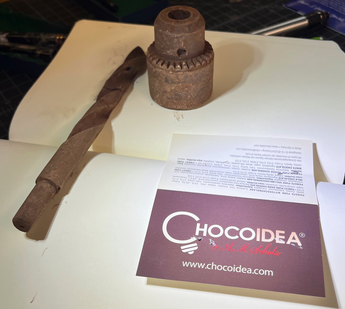

I recently purchased a high-end brand keyless drill chuck and can't stand it. I don't feel like it holds a drill bit nearly as well as my old PSI keyed drill chuck.
Whatever you do, do not get this one that I got at a holiday fair this weekend. It is nowhere near sturdy enough. The drill bit is terrible as well. It seems like it is made of chocolate or something. :D It tasted pretty good though.
hahahha, amazing, thanks for the picture and your recommendation.
