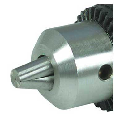

This drill chuck often mentioned as one of Harbor Freights better buys. You can read the reviews posted but many good reviews on various message boards too! If have a store in your area can exchange or get money back if get a bad one.
1/2" MT2 Mini-Lathe Drill Chuck
I do all my drilling with this, no problem at all. For $15, buy it and spend your money on other tools.

Really? Sorry, but this is not what I would call a quality product.
Image below is from HF site as directed.
