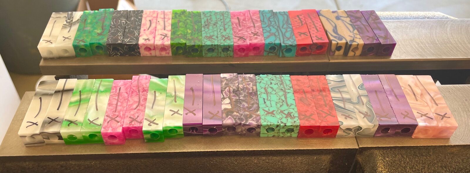

I am even more convinced that Norseman bits are my new standard. I bought almost every size I use now and will not go back to anything else.
44 blanks, ten bits rotated to keep them cool with each blank. All straight, smooth entry and exit. Both sides look exactly alike.
