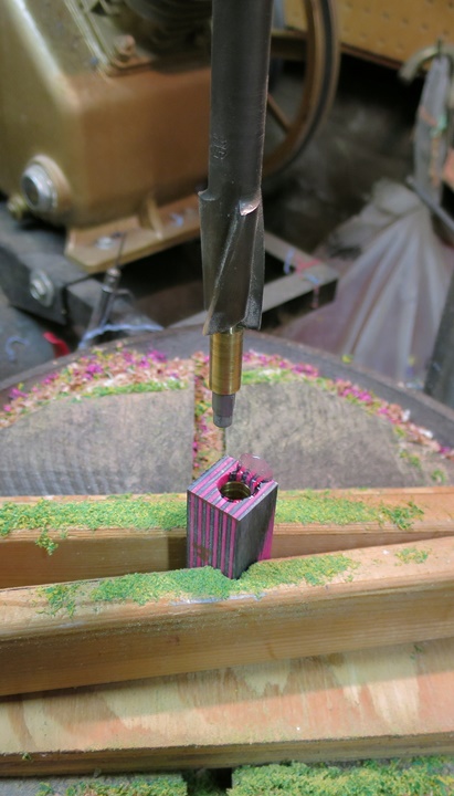

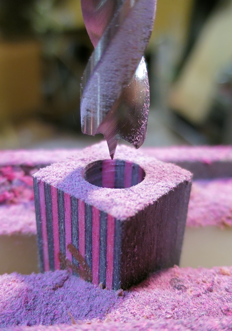

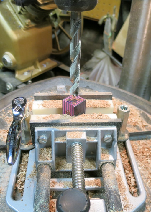

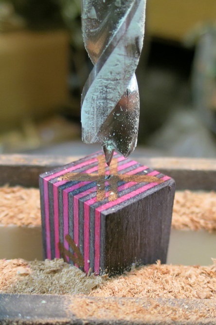

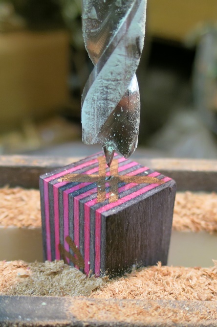

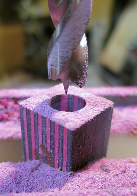

I use a 27/64" brad point drill bit that that I got from Woodturningz. I prefer brad points, in spite of the bad opinions of them. They work well for me. Woodturningz also has a carbide version which would probably last longer, but I haven't tried one.
27/64" Drill Bit - WoodTurningz
27/64" Carbide Tip Drill Bit - WoodTurningz
Woodcraft also has one.
Buy WoodRiver Pen Makers Bit 27/64 Inch at Woodcraft.com

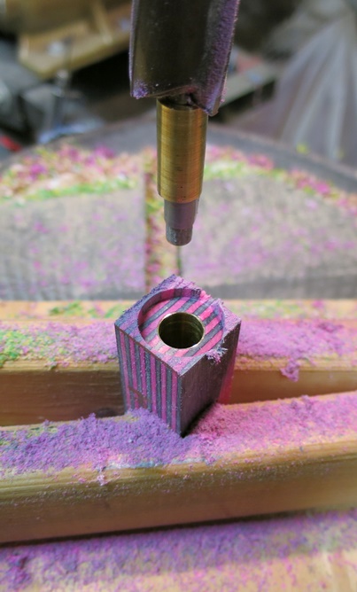

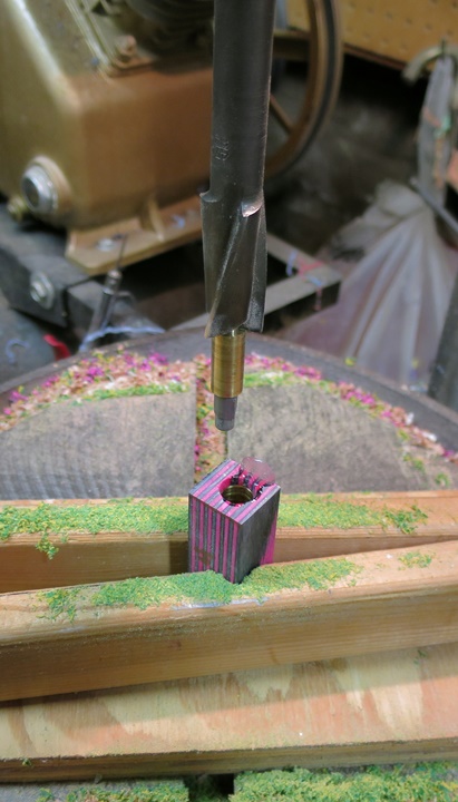

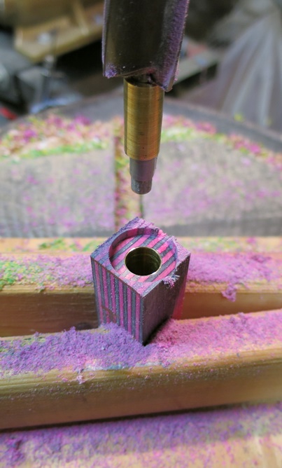

As for a barrel trimmer, I use a piloted end mill with a brass sleeve I made. Woodturningz has a 27/64 pilot for a barrel trimmer, and PSI has a sleeve that you put on a 7mm trimmer pilot.
Barrel Trimmer - Shaft only - 27/64" - WoodTurningz
https://www.pennstateind.com/store/PKGABTS.html
