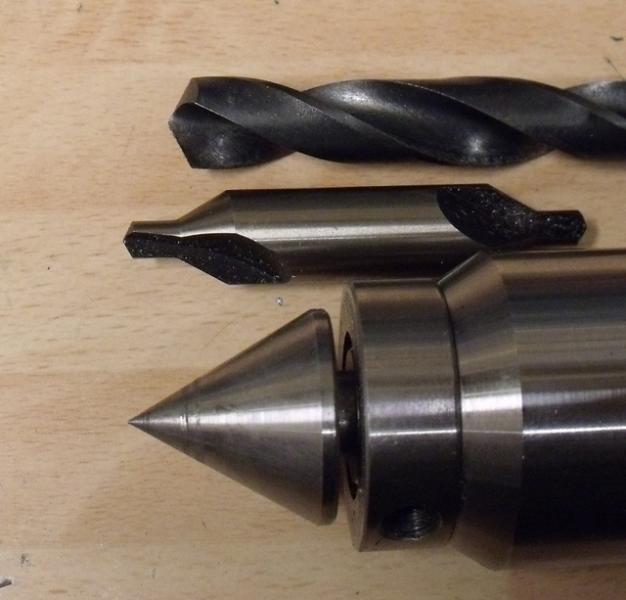

A centre drill is 60 deg incuded angle and a drill bit is approx 120 deg included angle.
Contrary to popular belief, centre drills weren't made so a drill bit would match. They were made so that a lathe centre would match. :wink:
Edit; Here's a pic that shows that a normal centre drill matches with 60 deg lathe centre, but not with a drill bit.
Centre drills ( originally called Slocombe drills ) also come with curved - rounded, cutting edges for ball ended drive centres.
A 60 deg centre drill should not be used if the tailstock centre is going to be offset to do taper turning.
