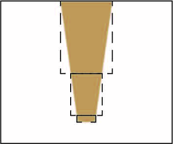

probably doesn't need to be a full taper. It could be stepped.

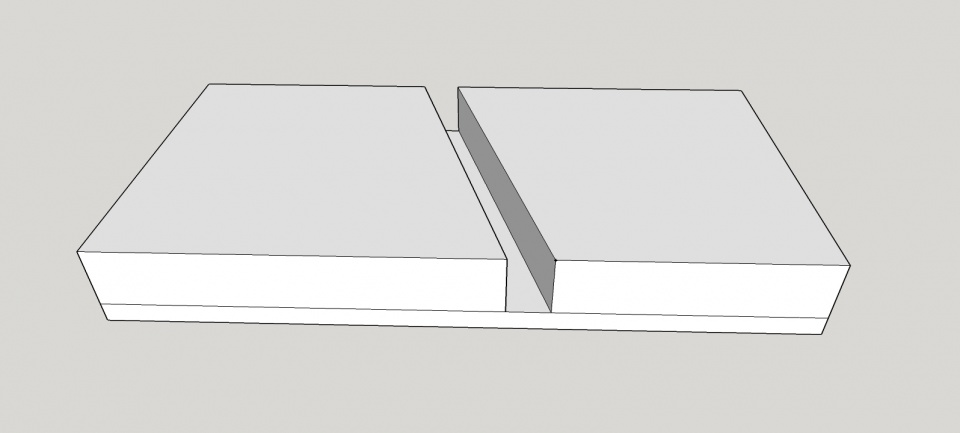

Well, If I was gonna do it.....
I'd get a cheap drill bit of a diameter equal to the largest diameter in your taper.
Cut a small piece of ply, the same thickness as your bit, at the 17' angle you need. Say a 1" piece of jointed/squared stock on the miter gauge on your TS.
Glue both sides to another thin piece of stock, using the drill bit as a spacer. Then glue a top onto that.
Mount this jig onto your grinder, square to the wheel. Put the bit in a drill, and slide it through the opening, and grind the tip down to the angle you need.
You'll end up with a sharp point that won't last long, but a small pilot hole should help with the drilling.
EDIT: I got the angle wrong in the pic. It's showing a blunt tip, but turn it 90' and it'll work. It's just a visual aid anyways, not a schematic.

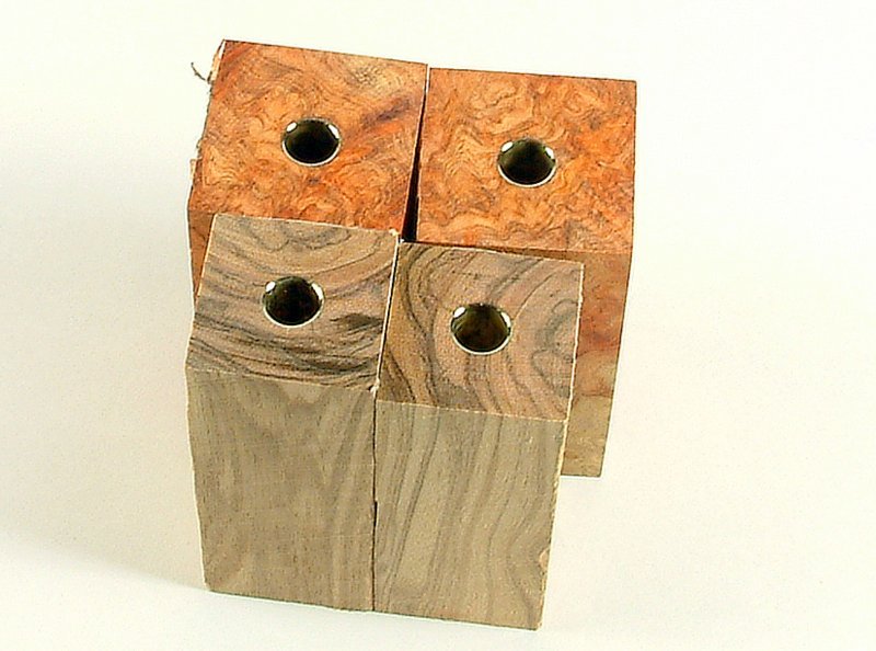

I have for 20 plus years used a taper reamer sold in electronic stores it fitted exactly the tip of a Slimline ,no fuss just exact, when I go to press I lightly ream the barreltop of the pen and the tip and then the entry to the winder. I use a 1 ton press I find ideal for the purpose.

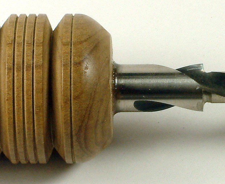

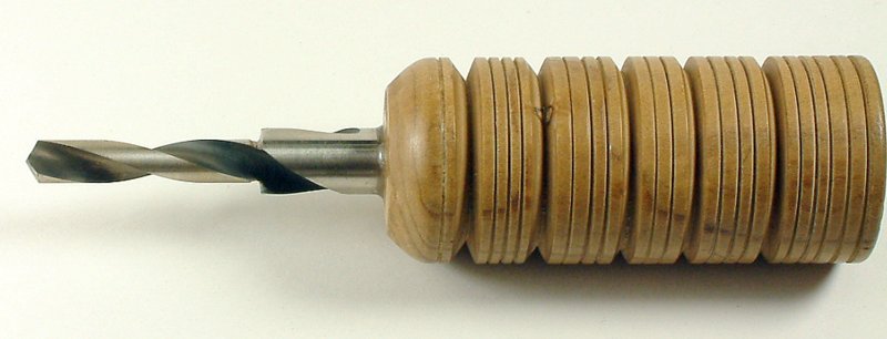

When slimlines were new all I could buy was a step drill that cleaned the tube, reamed the brass and faced the blank. I will look for some pics to illustrate.
Peter.
My 30 yr old Step Drill, the pics of the two blanks illustrate the reaming from the step drill and the small section is still a snug fit.
I face blanks on a 12 inch faceplate sander.
You already have a pic and the taper reamer I mentioned illustrated from Edward.
Always works for me.
Peter.
