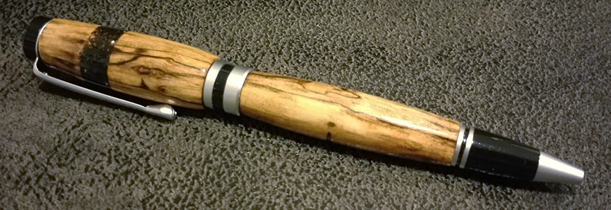

I have only ever turned one driftwood pen as a test. Was just playing around and trying a couple things out.
What I learned from that experience:
1) The wood (at least what I used) was VERY easy to turn... almost too easy. In fact, looking back I am surprised I didn't blow it out. Ed from Exotic Blanks (ed4copies) offers some really good tips for using thin CA to deal with punky wood that hasn't been stabilized.
2) The wood did change color. It was very grey and washed out on the outside, which leads me to..
3) I was extremely surprised and pleased with the color and spalting I found inside after I turned it down!
I'm sure every piece of driftwood is different, but that was my experience. (picture attached)
When I turned mine it lost its color and ended up looking like maple with weird grain. Had bits of dirty looking wood in it as well. Mine was also kind of a pain to turn. It seemed very dry and I had to use CA to keep it from blowing out.
I'd imagine it's a crap shoot for drift wood though. Mine was sourced from the PNW. Not sure what wood it was.
