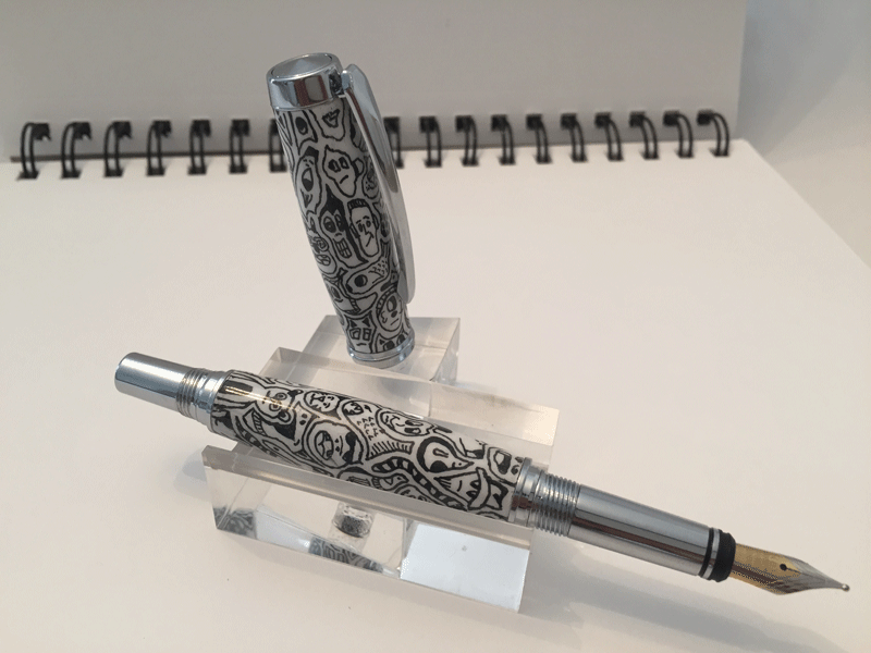

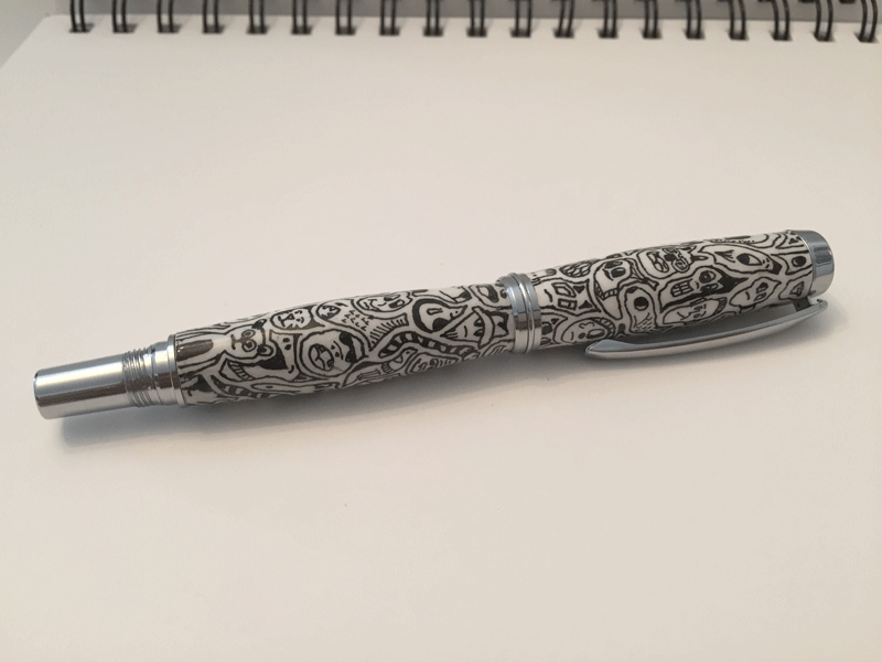

This is my attempt incorporating my art into a pen.
I first turned a normale piece of wood and then sanded it to 600 grit.
I then painted the wood in a white.
I took fine tip markers to it and drew this design on the pen. It took me a lot longer then I was expecting. First time drawing on a rounded surface. I sealed it with a clear acrylic. I did not wait long enough for the ink to dry so it smudged a little (lesson learned).
Finally i sealed it with a CA and micro mesh sanded.
This is the finished project.

What kind of material did you use for the base? Was it just white acrylic or something else. I was wondering because I was thinking of something like that myself. So some of the ink smudged when you put the CA down?

Very creative! I am also curious about the type of wood. Did you draw directly on the wood and then apply CA? Did you just use a fine tip Sharpie?

Beautiful work, wish I had the patience and the steady hand to do something like that. How long did it take you to draw that pen before you sealed it?

To answer some of the questions. I used a blank I had around my studio. Nothing fancy. The. I painted it. Then took a fine line marker to it.
It took me about 3 hours to make all the drawings on it.
I plan on making a series of 5 pens in this style. With different color backgrounds. All of them on smitty's caballero. I will post them when they Are done.
