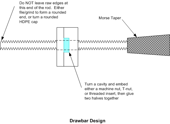

This sketch illustrates the components:
The nut that holds the drawbar on the outboard side of the headstock is turned from two scraps of wood. There should be a cavity in one piece to hold a nut of the appropriate diameter and threading. Alternatively, it is possible to use a T-nut or a threaded insert. Make the nut as plain or fancy as you wish.
I generally put a piece of heat-shrink tubing over my drawbar, leaving about 1/2" of rod exposed at the morse taper end. That prevents the sharp edges of the threads from abrading the inside of the headstock bore when the rod is inserted or withdrawn. The tubing should be slightly shorter than the length of the bore so that it doesn't interfere with the nut.
Leaving sharp edges on the left end of the drawbar is dangerous - DAMHIKT. As a minimum, file or grind the left end to form a smooth ball. Alternatively, I have turned a rounded cap from a scrap of HDPE that threads onto the end. Your left hand with thank you!
