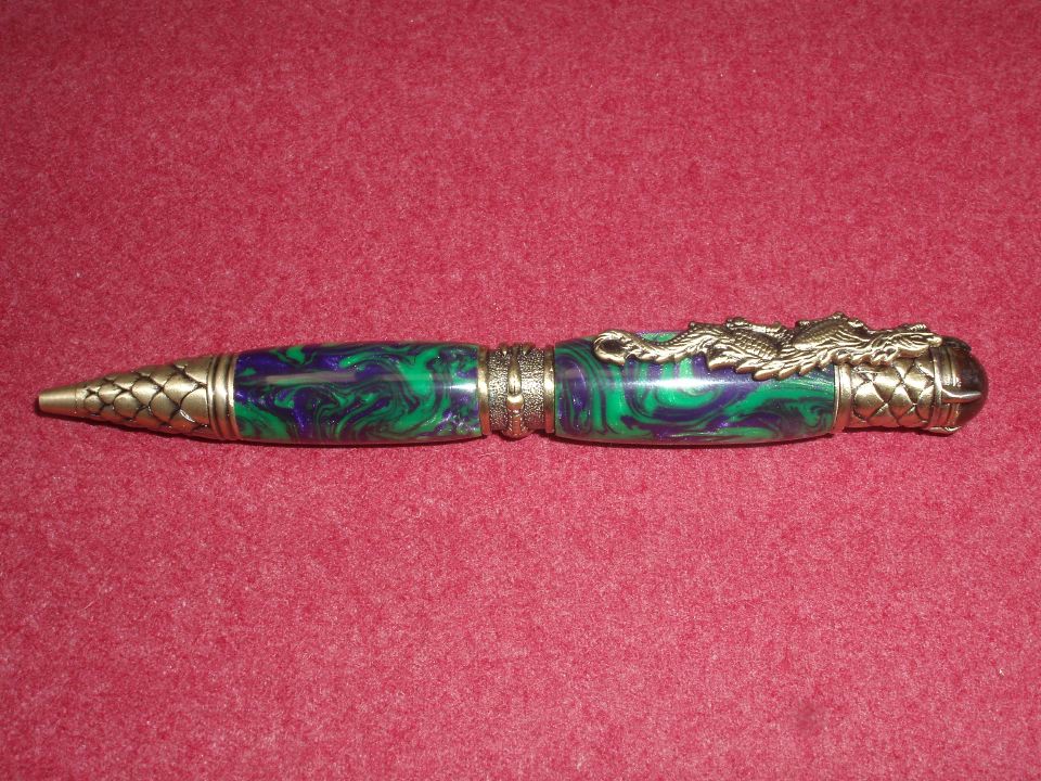

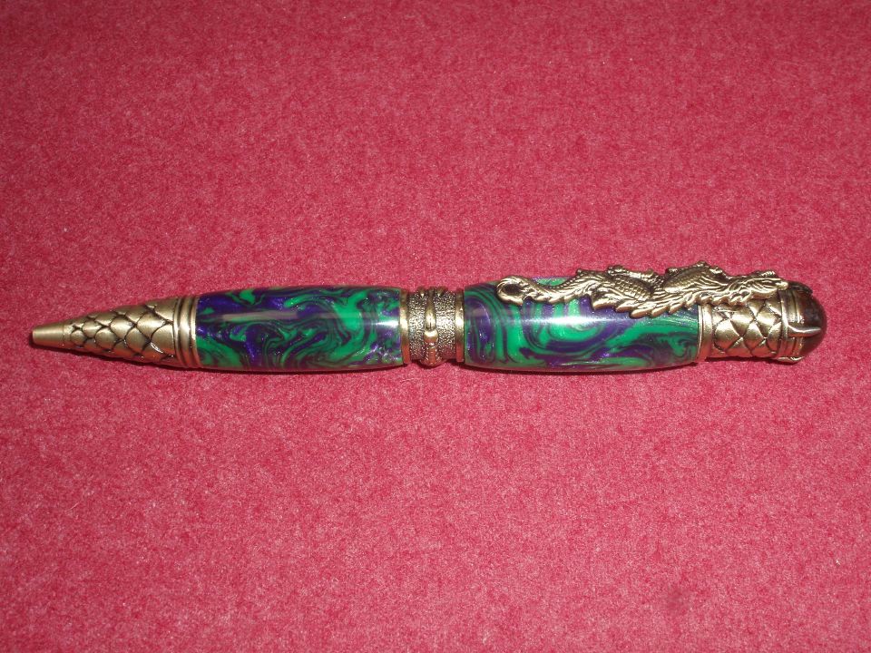

I ordered a Dragon pen kit at the end of May, drilled and glued the blank a couple days ago, and finished the pen yesterday. The blank is Inlace Acrylester "Nuclear Grape", chosen by my spouse for this pen. It will be a birthday gift for a young member of our family who is into dragons. I had no issues with bushing size or assembly. I turned it down to the bushings. It just worked.
