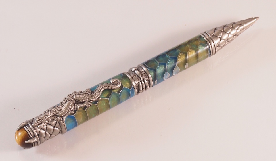

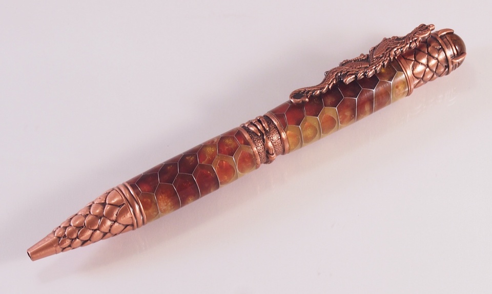

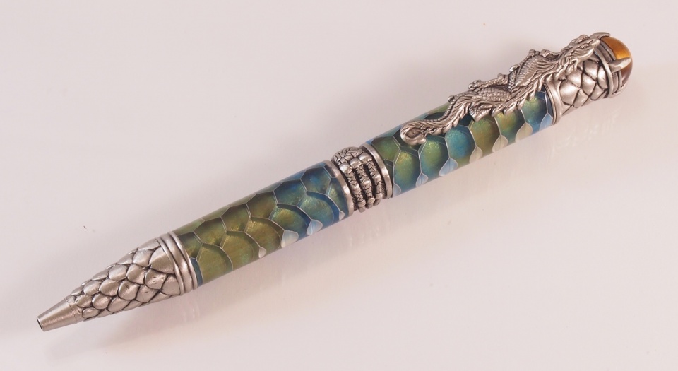

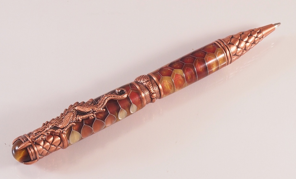

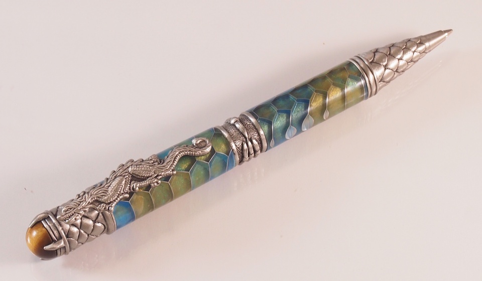

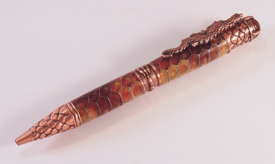

I did three color aluminum honeycomb casts with the idea of matching the colors to the antique copper and antique pewter dragon kits. I backpainted the blanks with chrome paint before gluing up the tubes. I planned on entering one of the two in the casting Contest but had trouble deciding which one to enter. I finally opted for the antique copper pen. While it placed third, I am still debating my choice.
I really like the pewter one. I think the match is so close on the copper that the hardware kinda blends together and there isn't enough contrast to appreciate the separate elements. Both are great, though.
Those are beautiful, Cody !!!!!
You seem to have mastered the art of making the honeycomb blanks in such a way that the brass tube "show through" is not problematic.
If I am right, there seems to be a little "show through" but it seems to be a delightful feature of your blanks on these dragons !!!!
I love the look of them !!!!
Nice! Did you have problems of resin delaminating from aluminum?
I etch the aluminum with Krud Kutter etching solution and cast in alumilite and that seems to help but yes you can have issues with the resin delaminating particularly when you have a partial cell. Keep tools very sharp and take light cuts.
