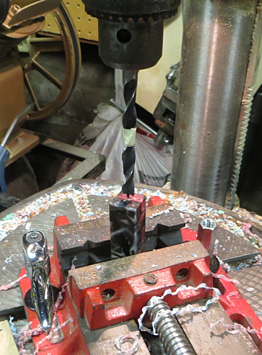

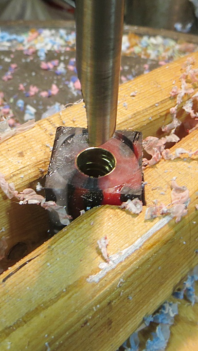

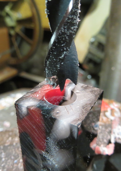

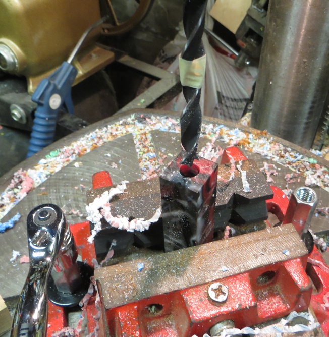

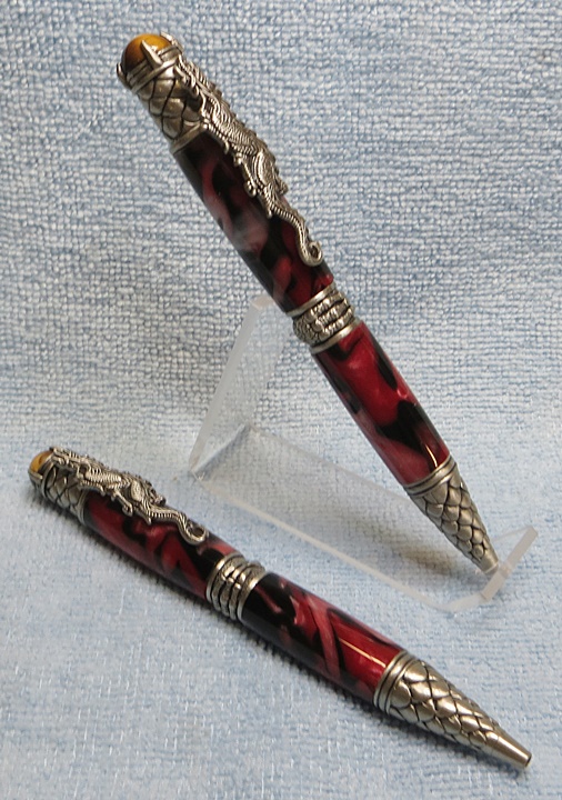

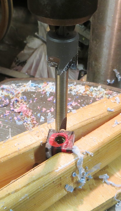

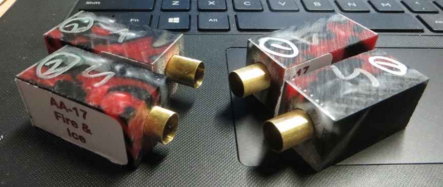

How are you securing the blank when you drill it? In the past, I tried holding blanks in a "gate" jig, but didn't get very accurate holes. I now use a drill press vise with a prismatic jaw, secured to the drill press table. I've made two of the dragon pens, but didn't have any problems.

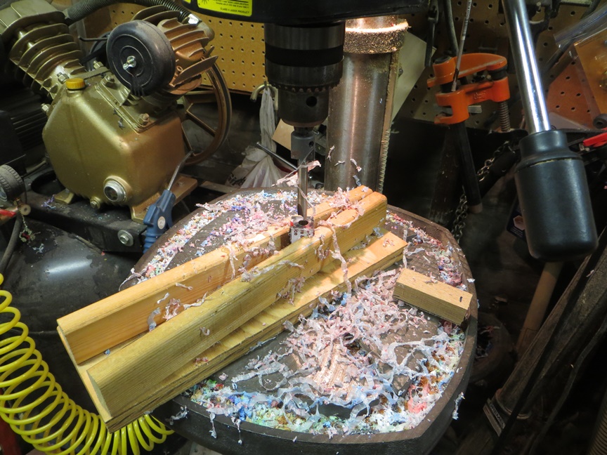

By the way, this is a gate jig. I only use it for holding blanks when I trim them.
