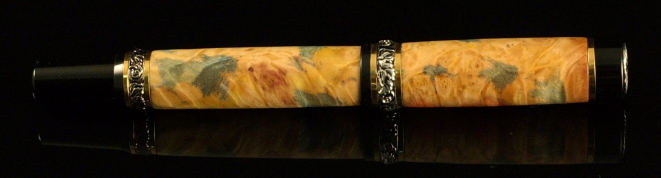

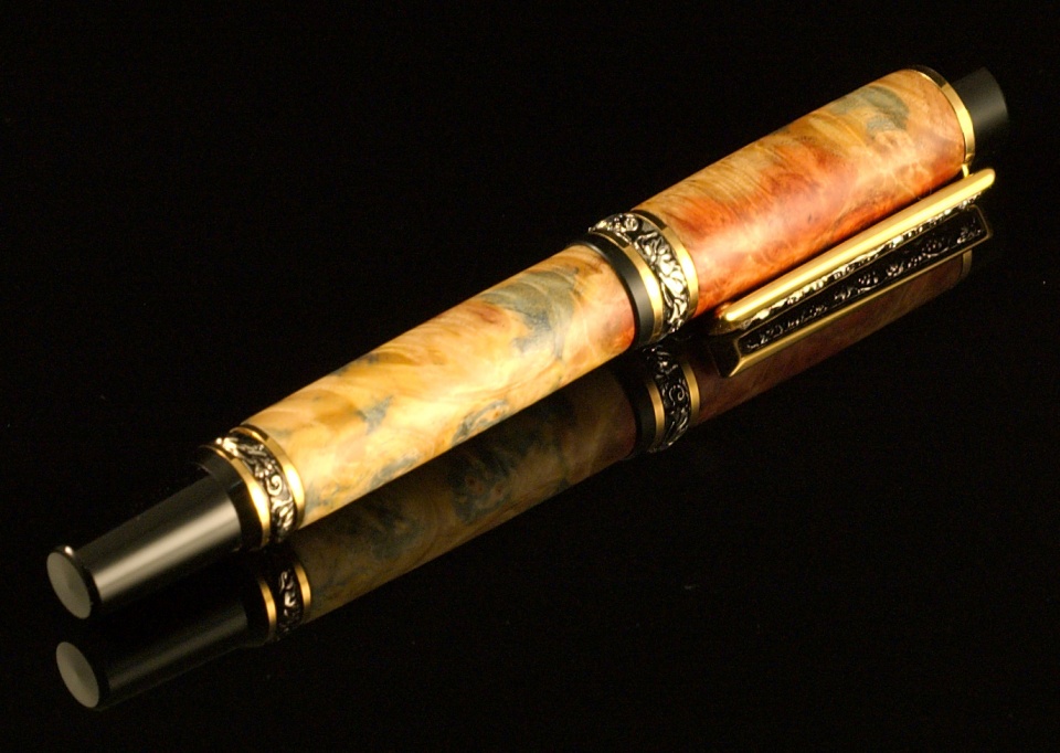

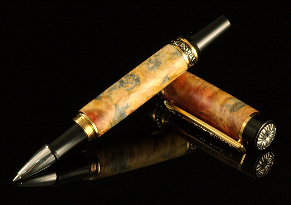

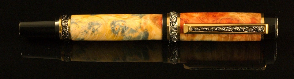

So, before all that begun, I've been playing a lot with new stuff. First to show - doubledyed gold/blue/red maple Cambridge.
No, I'm not mistaken. DOUBLEdyed. 2-stage process, three colors(actually, even four, if yellow natural counts:) Guess how?:)

Used an eye dropper to drip red and blue resin and let the wood soak it in as it wanted, cured that and vacuumed the gold in to complete the stabilizing.

I have wiped dye on a almost finished sanded blank, then sanded most of the color off, and wiped another color on, then sanded most of the color off, then finished. I happened to be using two different colors of wood stain to bring up the color in a pen that had pretty grain but not much contrast. First I wiped on the darker stain, sanded most of the color off, then wiped on the lighter stain, sanded again, then finished. Wound up with a pen that looked like marble.
Answer is a bit simpler:)
First of all, it was a red flame maple. So it already had splotches of red and almost brown colors. Then, simple double-dyed in blue and gold. Because of the structure of wood blue went only on some parts of burl, then yellow went to other places, leaving red and brown almost intact (yellow is much lighter then this colors). So it was all mostly work of nature and my experiment:)
Thanks for kind words and guesses.
