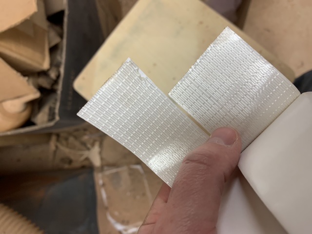

So I bought a roll of this tape years ago, I thought I bought it from Home Depot and I believe it was "carpet tape". But I can't find it there now.
This tape was great, I could tear in by hand and it had very good adhesion. I bought a couple other carpet tapes and they all suck by comparison.
So what is everyone else using?

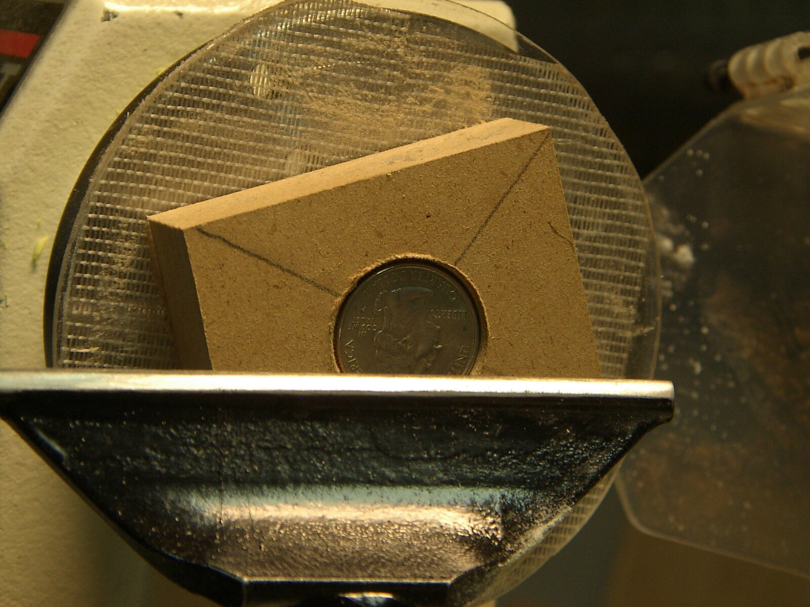

I do not know what type tape you are using but you do need to be careful when using doublesided tape on a spinning lathe. The brand that I am talking about is "Duck brand" and it is an outdoor fabric tape. You can see it here on an earlier model sanding disc I made for my lathe. I since replaced the acrylic pieces with a sheet metal backer.

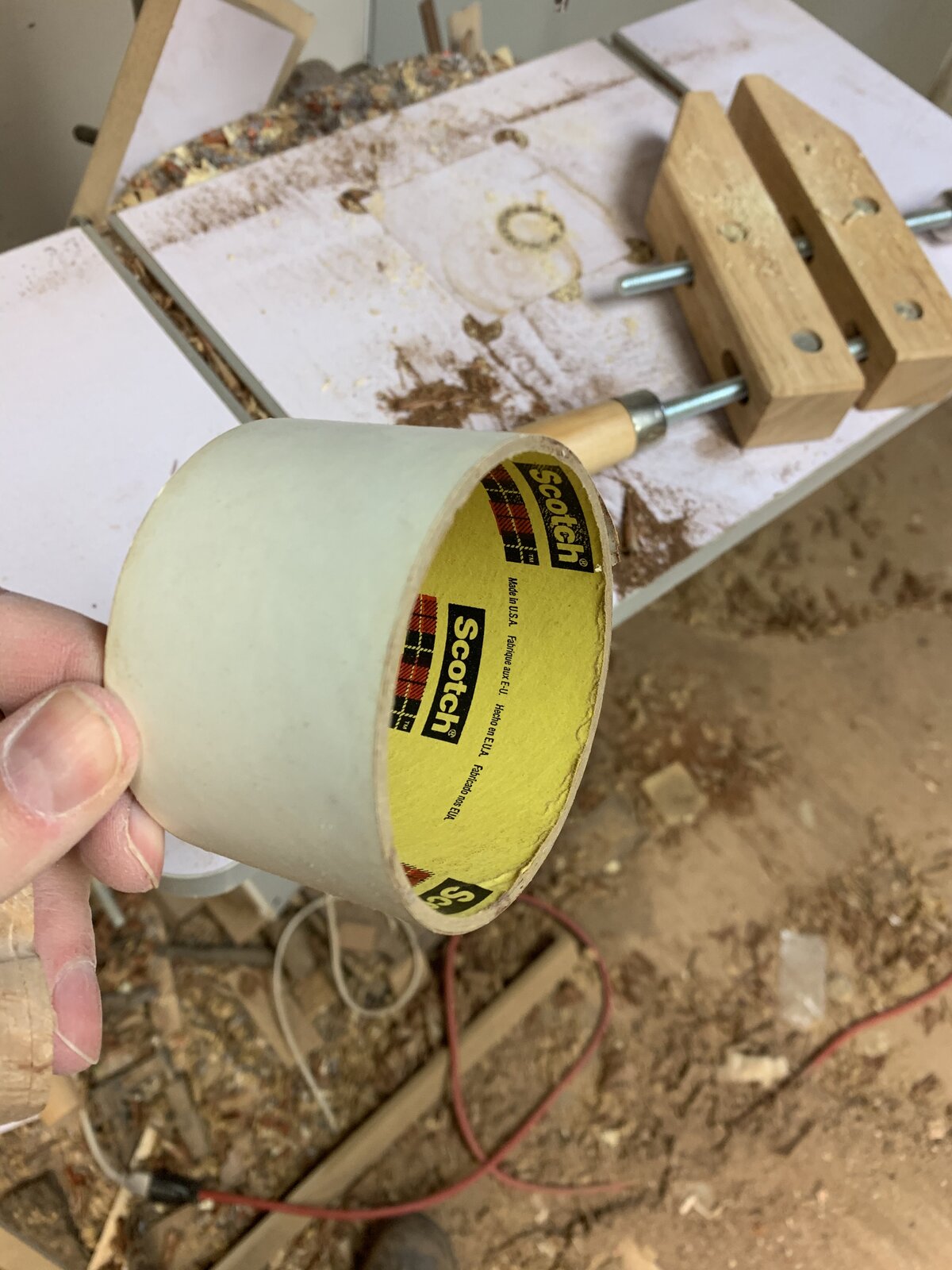

So side note the outdoor shurtape and outdoor duck tape are the exact same tape... even the cardboard tube inside is the same, just different widths.
I can't tear it by hand like I could with my old tape, but I did have much better results compared to the stuff I tried last week.
Yes that outdoor tape is a bear to get off if you leave for any length of time. I use that only when absolutely need things to keep from flying off.
