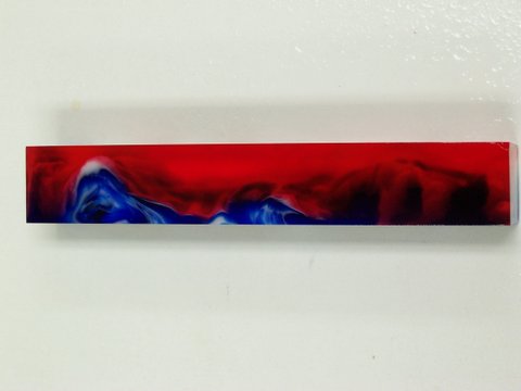

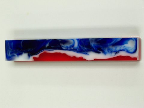

I have had a hard time with alumilite clear actually coming out perfectly clear. But I have done double casts. Alumilite sticks to itself very well, even after the first one is set. You can also cast alumilite clear and alumilite white at the same time while they are both liquid. That turns out pretty cool too.
