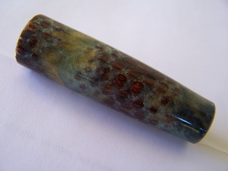

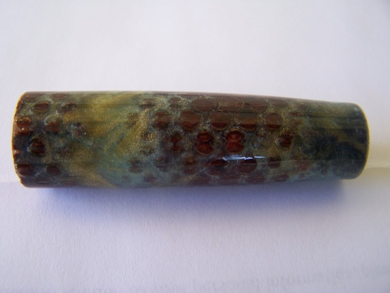

I finally got my mini cones died, hardened(not stabilised) and cast with gold and light blue poly resin.
Carefully drilled the blanks and glued in the tubes. Oh yea, these are goin ta be goooodd.
Turned this half to fit a cigar and was really happy with it. CA finish was good.
Then I started on the nib end, Gee Whiz, well that's not exactly what I said, 300 pieces all over the shed floor.:mad::mad::mad::mad:.
So now the tubes are back in the cigar box, ready for the next try.
Thanks for looking.
Bob.

So the whole thing shattered on pressing Bob? Just want to figure out the what's what. I've had that happen with soapstone. What are you thinking was an issue? Those were some cool looking blanks!!
Jim,
It flew to pieces while still on the mandrel. I think the cones were still not hard enough and let go of the tube.:mad:
The half that exploded was looking even better than the surviving blank. I think I will have to get the cones stabilised and then use them on larger size pens, as they are a bit big for the smaller diameter units.:confused:
