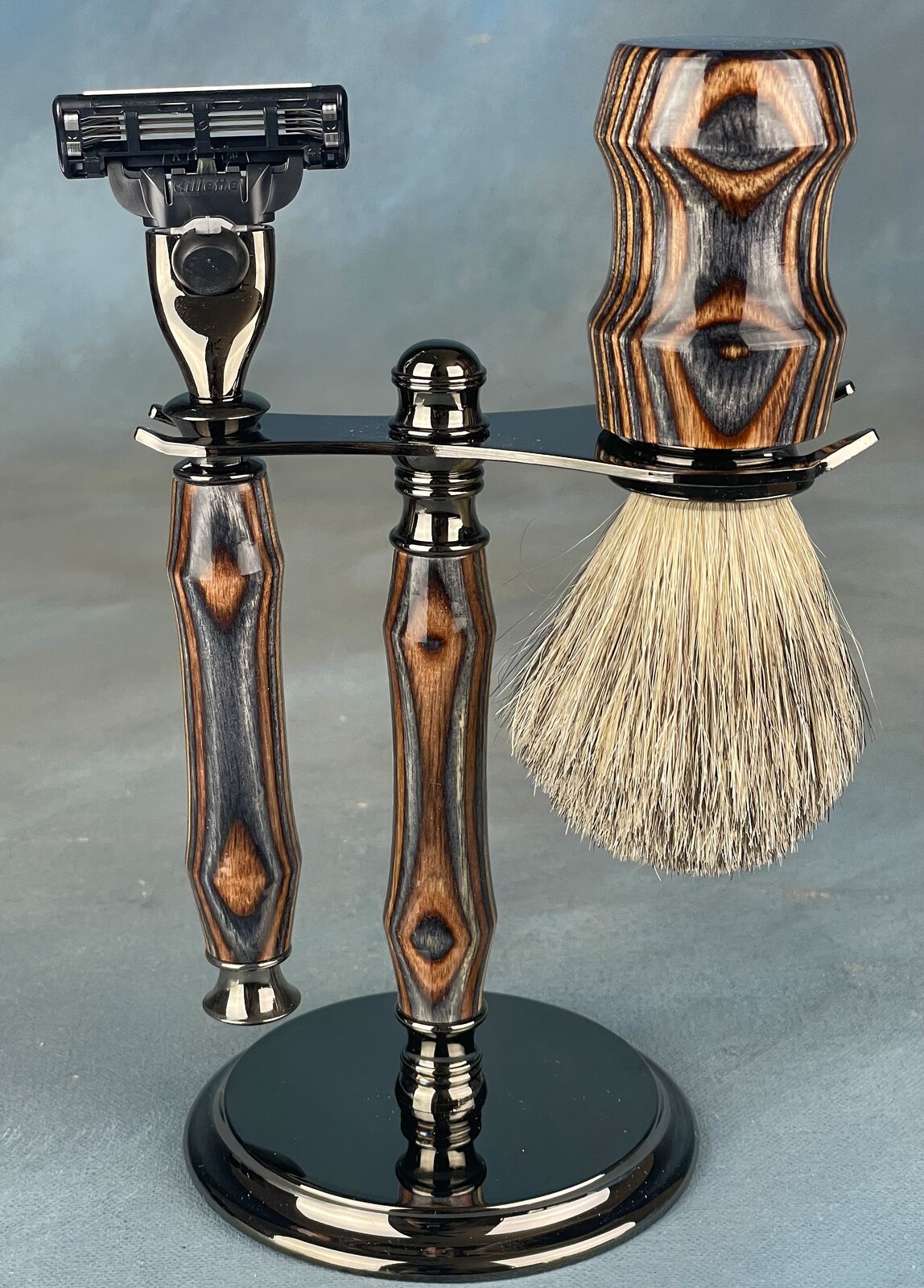

I just made two of these sets after requests from last weekend's show. I like it.
