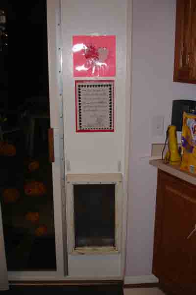

I picked up my door at Home Depot, them I used 3 pieces of 1/2" plywood to make the insert, some strips of aluminum for the door to fit in to, the plywood is glued and screwed together to create a 1 1/2" thick insert.
Mike
