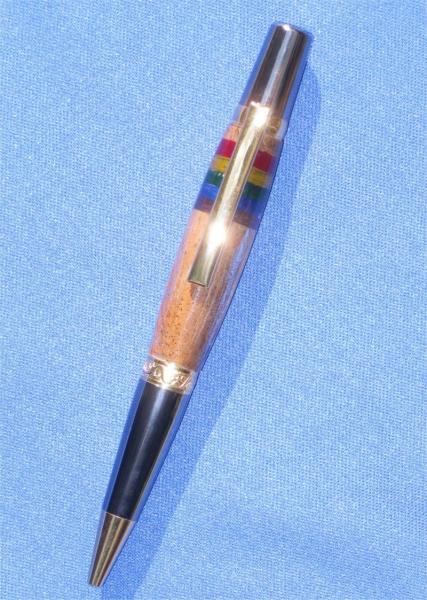

Well the pen is done. I turned all the blanks I cast and used the one I liked best even though I didn't like it. The hair almost disappeared when cast. I offered to make another pen using a picture but he insisted on seeing what I had. I showed it to him and he loved it. He really liked the fact that I was able to add the rainbow he wanted.
Thanks for all the tips and suggestions but I think I'll leave casting to Dawn, at least until the next time.
Dave

The pen looks good even though I can't see the dog hair in it, the rainbow part turned out nice. As long as the customer is happy it's all good.

OP - I REALLY like what you did with the rainbow (allusion to the Rainbow Bridge, I assume) nice work, and an inspiration.
