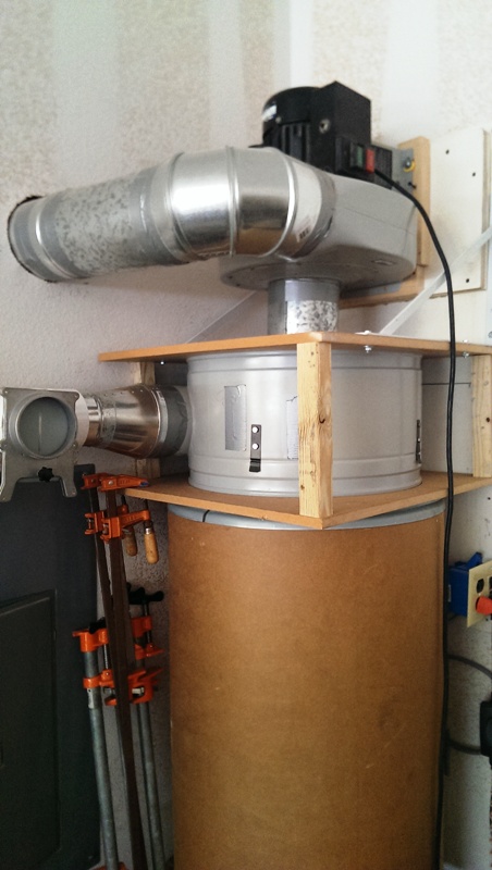

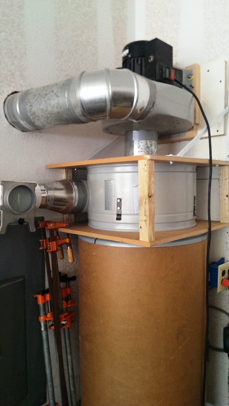

If you want to get crazy -- here is what I did with my Delta 50-850 dust collector. (It is a similar design to the HF unit that twinsen suggested). If you have the luxury of being able to exhaust outdoors, you can set up like this. For those cold Georgia winters or when you need to recirculate the air, you could run the exhaust duct into one of the rigid Wynn submicron filters. (there is a library article to mod a HF unit for one of these filters. None of the bags are really safe from what I have read. They catch the nuisance dust and pass the killer particles on to you (but the shop looks clean). It is my understanding that 1 micron is not really safe, but I defer to Jim on that.
So here is what you see in the picture:
  • In the middle, sandwiched between 2 pieces of 3/4" MDF, is the separator ring from the Delta. They are grooved to from a tight seal to the ring. The top one has a hole for the pipe that goes to the impeller. The bottom has a Thien baffle slot that runs 240 degrees around from the inlet.
  • Large particles drop into fiber drum below.
  • Virtually clear air is sucked up from the center of the Thien vortex into the impeller and exhausted outside (top pipe)
  • Motor is above the impeller
  • Inlet to the ring is the ductwork to the left in the center of the picture.
There is a cross-section drawing of the separator ring in my Gallery if you want to see it. Since I am an ex-aerospace guy, I used a 6" bell mouth entry to the impeller intake duct. You can further improve the airflow by using some flow straightening tubes inside the impeller intake duct :rolleyes:
This thing really moves the air and the Delta motor and impeller is pretty quiet. Separation is almost perfect as no dust builds up on the exhaust flap or surrounding area outside.
