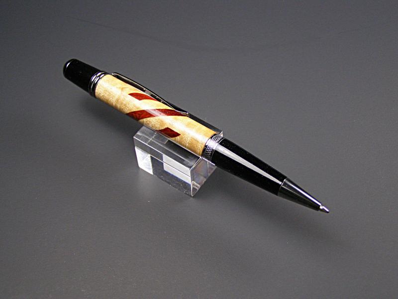

check out the attached photo. I don't have a table saw and did this on my mini mill. ------- My advice, BUY IT.

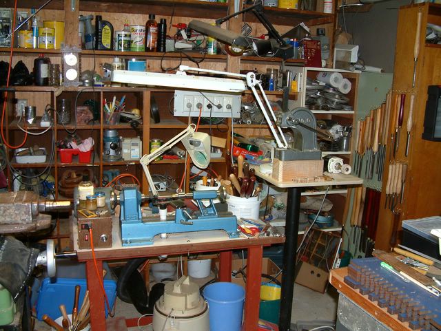

Grab it with open arms it is designed for multi purpose be grateful for the weight when its in situ. With a little imagination and an indexing method there are limitless applications in store for you, 3/4 of the work is done for you it will increase your accuracy immensely.
Because it is in effect a Mill Drill they are extremely versatile I value mine above any drill. I did modify mine at the quill lock and fitted an electronic guide up and down movement. Also it has a hollow spindle allowing the locking of the chuck or fitting other devices etc.
Did I say I really love mine. Just noticed your other remarks depends on you anyway just my handle over the last almost twenty years in using mine it is my go to.
From this pic you can see one of the movement handles, the heavy vice on the LHS of pic this bench enables me to sit on a draughtsmans raised chair I simply swivel left and operate the Mill Drill. My workshop has spewcial areas in 30 metres foreshortening of the lens looks cramped but isnt. This set up 15 yrs ago now refined somewhat the lathe a VL100 the brown box on the table vari speed infinite control, pen press on the right eye height etc.
Kind regards Peter.

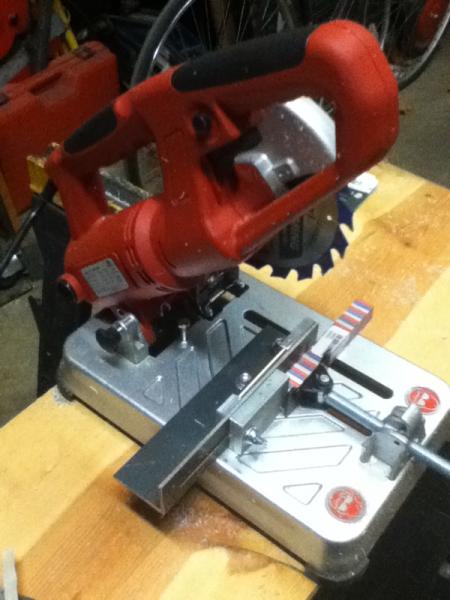

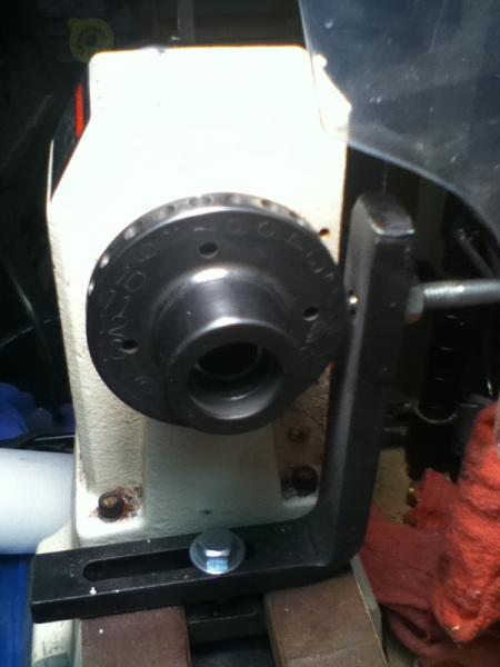

I use a Bridgeport mill at work, and honestly, if your not going to drill over three inches deep, and its a good price with tooling, I would go with that over a drill press. We machine aluminum as well as steel and wood. I've even gone as far as putting a piece of round bar stock in the collet and a lathe cutter in the vise and used it as a vertical metal lathe. If it has a digital readout, you can cut slots within a millionth of an inch and move it in any direction you need and duplicate it. In the pics below, you can see the slots I cut and for the indexing, I used it to drill the holes in the edge of my face plate. So with some thinking and good tooling there not much you can't do. In fact the bolt action pans are machines on something of that nature.
