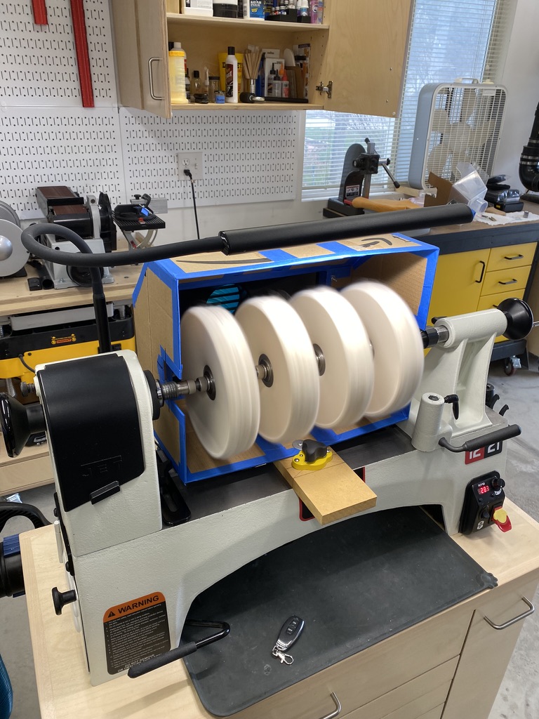

I took a 14" length of threaded rod, turned a morse taper end from purpleheart and glued it on one end, drilled a 60 degree hole on the other end. Got 4 flannel buffs from Caswell and used locktite to secure the wheels with nuts and washers. Everything but the wheels cost less than $8. When not in use it fits in a shopping bag at the bottom of my tool cart.
did the same. in fact, the library has my instructions. holds 4 buffing wheels
I used Tony's instructions and love my setup.
Rick Herrel (@rherrell) made me an MT2 with 1/2"-13 threads for one end and the other a 1/2"-13 with a 60 degree indent for my live center.
