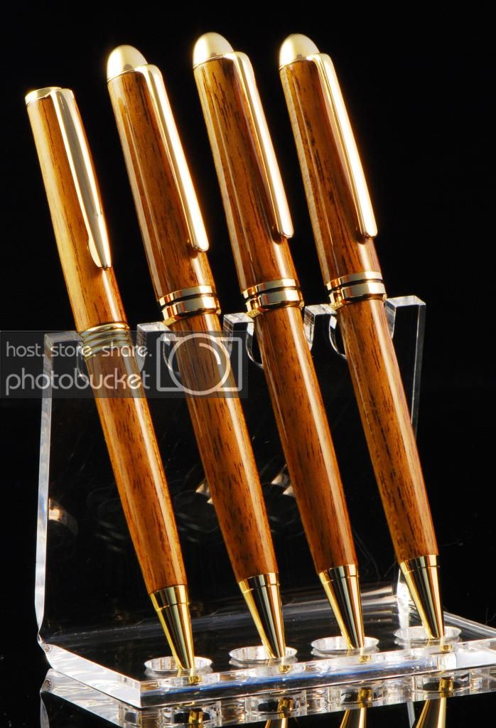

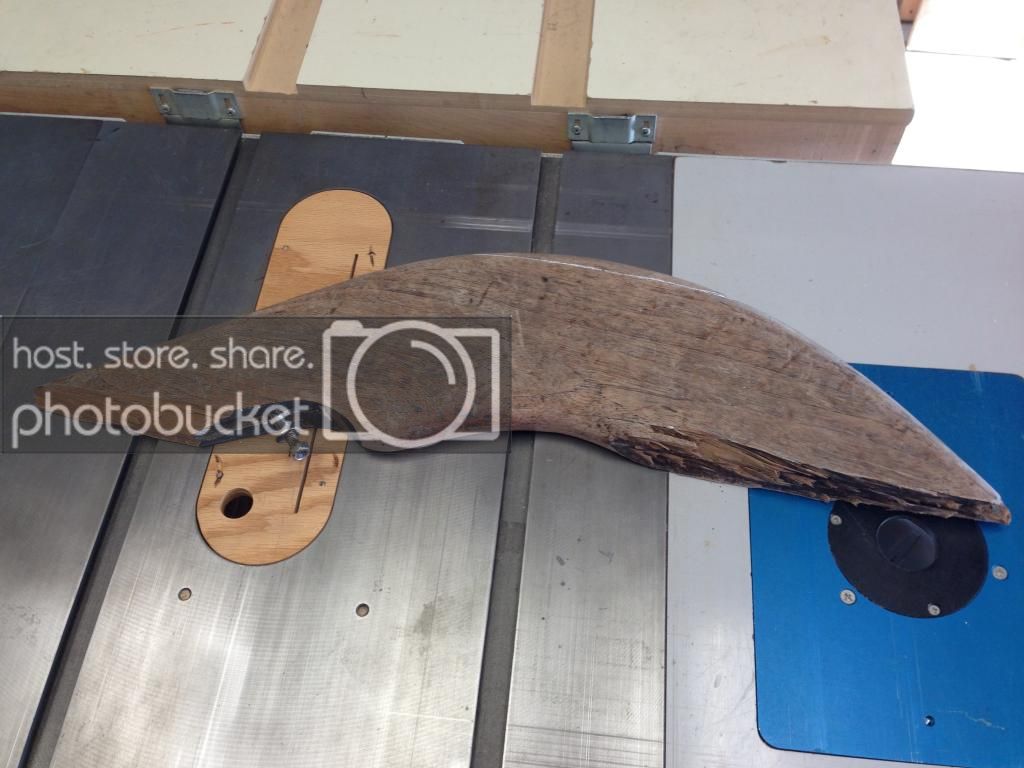

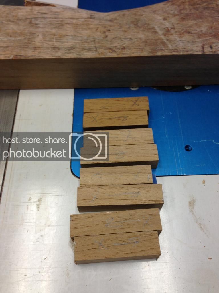

I had a project that took very heavily weathered teak wood from the rail on a long range fishing boat and used it to make pens. The wood was sun bleached and some brown stain made it look like the rest of the boat with beautiful varnished teak wood. The raw teak also had a nasty (IMO) green appearance that needed a remedy.
Before:
After:
Now I think I will use stain and some light coats of spar varnish to impart more yellow before CA finish. I have some diagonal cherry that may get some stain before finishing it too.

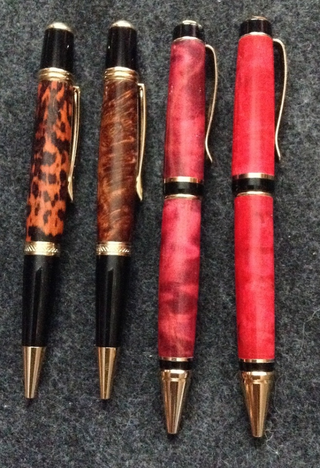

I prefer dye, and top coating with CA or other film type finish. I would be afraid of a thin friction finish like you are talking about on top of stain. It will wear off pretty quickly. I also double dye, black dye on first, heavily sand with 320, then dye with another color. The first three from the left are double dyed, the last one on the right is just dyed.

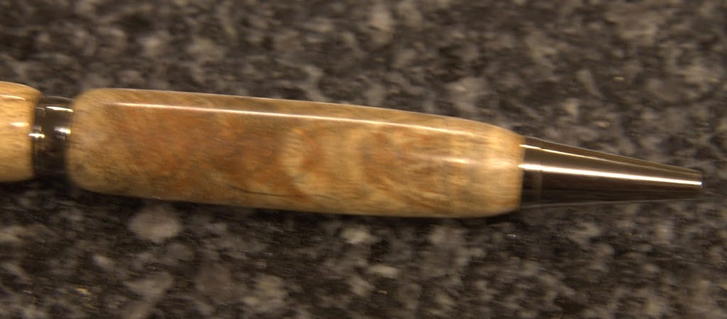

I often sand to 400, then put on a little wiping stain and let it dry, then sand again with the 400 taking off almost all the stain, but leaving it in the softer parts of the grain. The result is very like marble. Then I micromesh and finsh as usual.
This isn't a very good picture, but all the reddish parts are a chestnut stain I applied to a mulberry blank, then sanded almost off.

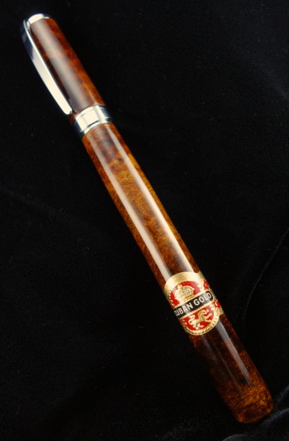

I prefer to use a dye on the highly figured burl on my closed end cigar pens in order to replicate the look of tobacco leaves. Dye accentuates the grain better than a surface-level stain, providing a richer and deeper look to the figured wood. Once the dye is dry, it takes a CA finish beautifully.
