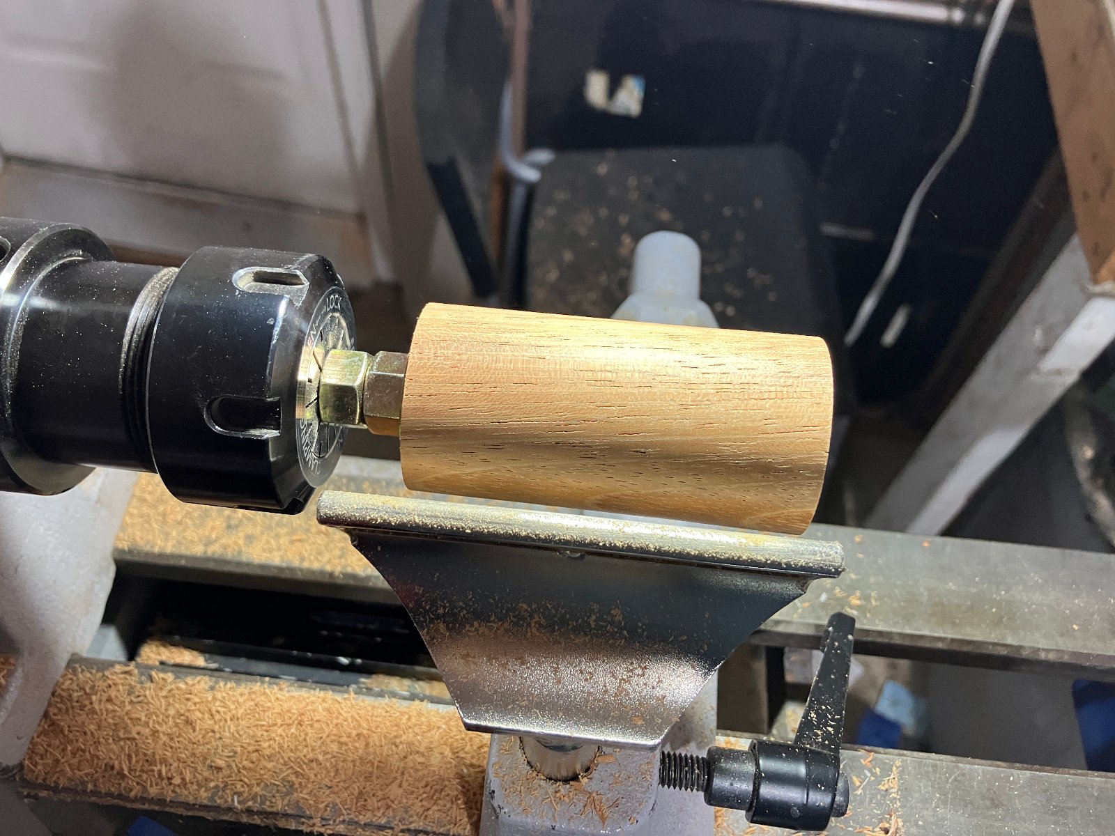

First attempt at using the $2.50 screw mandrel yesterday. It's a single partially threaded 3/8" coarse bolt. Chopped the hex head off with a dremel, threw it in my collet chuck, and added a couple of nuts and a washer to give the wood something to butt up against (and to expose only the amount of thread I wanted to go into the workpiece). This is a piece of jatoba. I had to experiment a little bit with finding the right size of hole that let the bolt threads cut in and get a positive grip without being too tight or risking splitting. For this wood, 8mm was about right. Perhaps a hair tight; I might try a tiny step up for the next one - I have an 8.2mm bit. Or maybe I'll try actually tapping the hole with 3/8 coarse threads after drilling before I mount it on the "screw chuck".
But it's turning very concentrically even without the tailstock, it's gripped in tight, and it gives me plenty of room to work with the wood and not worry about running my tools into chuck jaws or anything. I think this will likely work out great as I turn this chess set.

Yeah, I'm very happy with it. I turned a pawn yesterday from the piece of rounded stock shown in the picture, and aside from taking a slightly unreasonable amount of force to un-screw it from the "chuck" (I guess technically a mandrel?) after it was done, it worked perfectly. Pilot hole a bit too small, I think. A good argument for using the 8.2mm bit next time.
