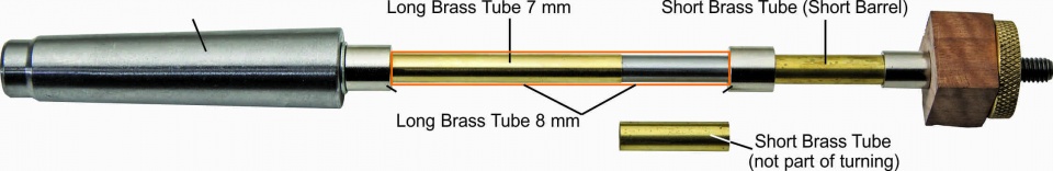

I think my answer is yes I'm doing something different. I'm moding this kit for casting and need one long tube from clip to trim ring.
Top Long Style Chrome Pen Turning Hardware Kit | Rockler Woodworking and Hardware
Here is my plan.
I'm adding a 3" 8 mm tube that will be wrapped, its a surprise mostly because I'm not sure its gong to work :).

Ken,
My knowledge of metrics ain't too good, so could you tell an ole country boy how 8mm is larger than 8mm !!
Ben
The difference is in labels and that is why the caps. The dial calipers show smaller numbers with the Pencil tubes. PSI notes that the Pencil tubes do not work for pens.
The pencil tubes fit inside 30 cal rifle case mouths and the pen tubes do not.
Note that the 8mm is the convention of which drill bit is normally used rather than a measurement.
