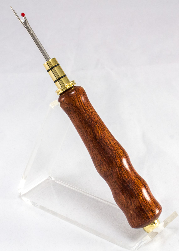

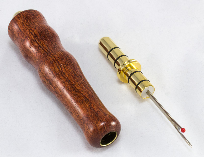

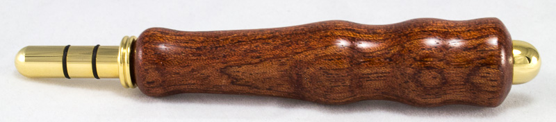

After reading this thread I decided to try out Dr. Woodshops Pens Plus for myself. Although I get great results from CA and have only minimal reaction to it, I'm always in the market for alternative choices, particularly if they are easier.
Having turned my first seam ripper yesterday, which will be gifted, I dry sanded the Bubinga up to 400 grit as I normally do (sanding each grit first with the lathe on, then along the grain with the lathe off). I then wiped on some walnut oil to see how the grain would look (Mahoney's Walnut Oil from Woodcraft). I wiped off as much of this as I could and then set it by rubbing it with paper towel with the lathe at high speed.
Next I put 3 or 4 drops of Pens Plus on a small 3"x3" square of terry cloth and wiped this on the wood with the lathe turning about 200 rpm. Using the same spot on the cloth, I then friction polished the coating by turning the lathe speed up to 2000 rpm. This whole process took about 30 seconds. I then repeated these steps and put on 3 additional coats of Pens Plus, friction polishing each coat. Total time, about 2 to 3 minutes start to finish.
I've got to admit, I really like the results. A nice semi-gloss finish that has some depth to it. And it can't get any easier, less than 1/4th the work of a CA finish. I'll have to try this on a few pens. While it's not a replacement for a glass-like CA finish, I can see where this will have a place alongside. I thank everyone for bringing this product to my attention.
