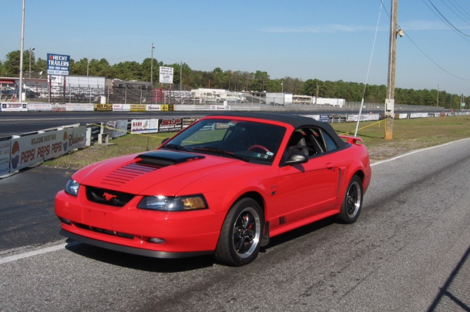

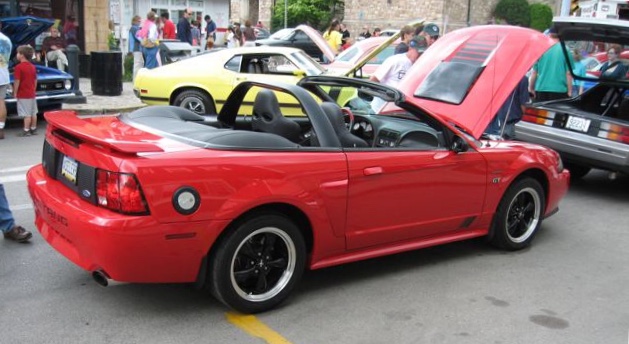

Im still enjoying my 02. Biggest problem is not driving it enough. Best ride I ever owned.
