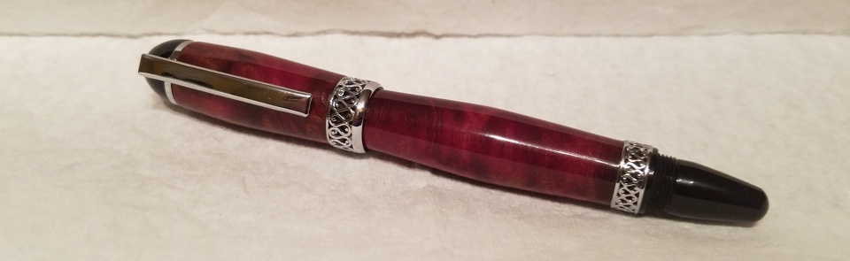

I just wanted to say, I finally beat my nemesis. It fought me to the very end, stripped the finish 3 times to get it right. It even gave me a hard time during assembly. Alas, here it is the Nemesis (Apollo Infinity) in Camphor Burl.
As a side note, I don't think I can ever sell this pen. It would be impossible to recoup the time and effort that went into it.
