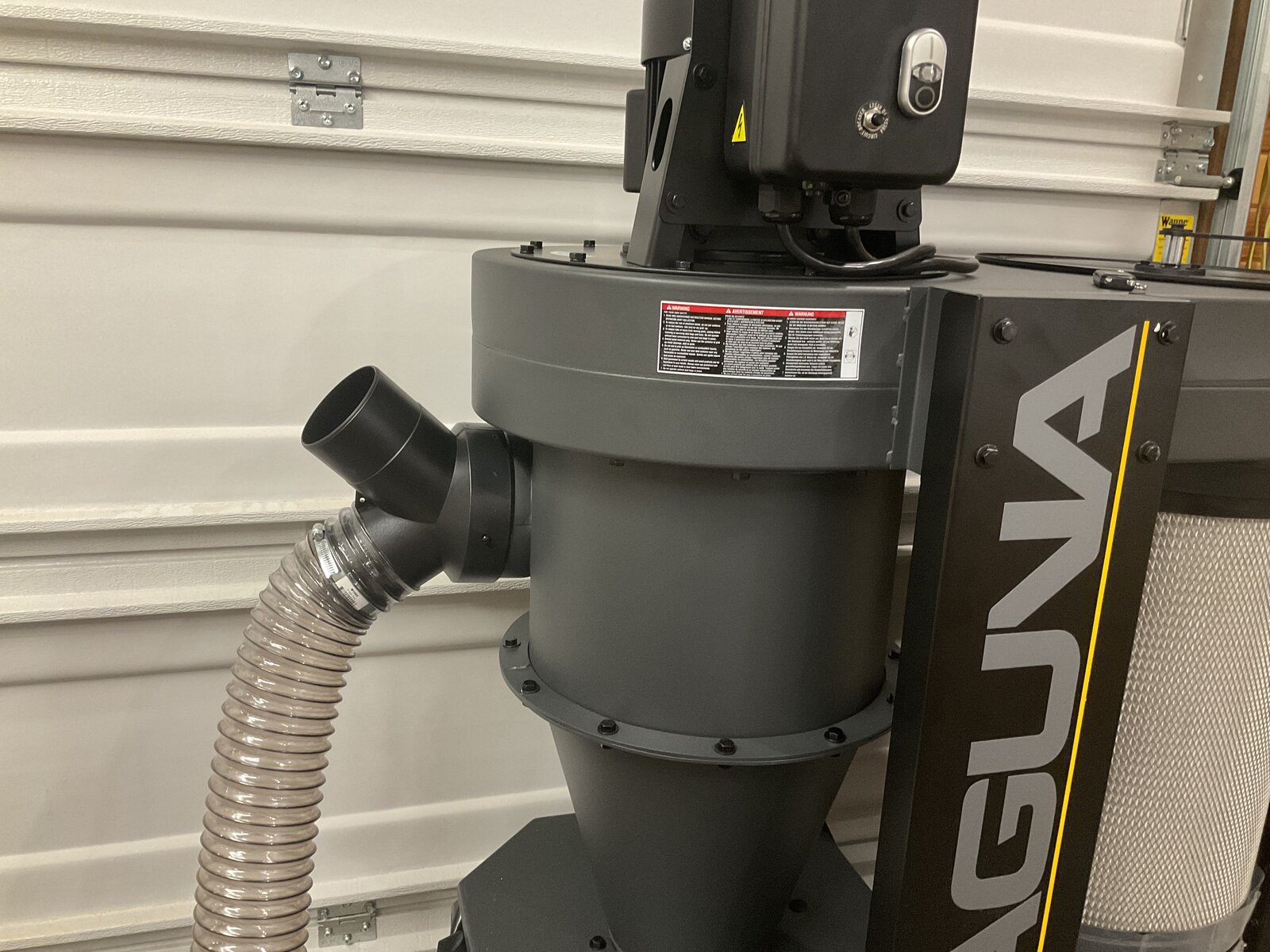

Lets assume you have a Y on yours. You can only connect one hose to it. The second port must not be capped. It must stay open to the shops air. You must always have a minimum of (2) 4" ports worth of air sucking into the machine. Many machines have 2" ports. You would need to keep 3 of these machines open with no blast gate all the time. That second port on the dust collector is actually a whole shop air filter! While your working it is cleaning the shops air at the same time. When finished working you are supposed to set the timer for 5 minutes to clean the air your breathing. Its as simple as that!
You can even use your man logic to understand it. That Y splitter is really a 6 or more inch hole. Thats your straw. The size of your filter is your lungs. If you cap everything off to a tiny straw you dont get more suction, you get less.

Montmill. Basically this is how your Y fitting should be. The second hole is just open to suck in air from the shop. If you want 2 hose coming off the unit, you remove the Y and install a triple. Unless you have like 2 dozen big tools hooked up, you probably dont need any blast gates at all. Most of your tools do not require maximum cfm. You might find that you have a few more larger chips landing on the floor because of reduced cfm, but you will find yourself dusting your shop less often. You cant breathe in chips, you breathe fine dust.

I will point out that those Y fittings reduce the efficiency of cyclone or a single stage DC because of the turbulence they create. There should be several feet of straight full size duct to the DC to smooth out the airflow.
