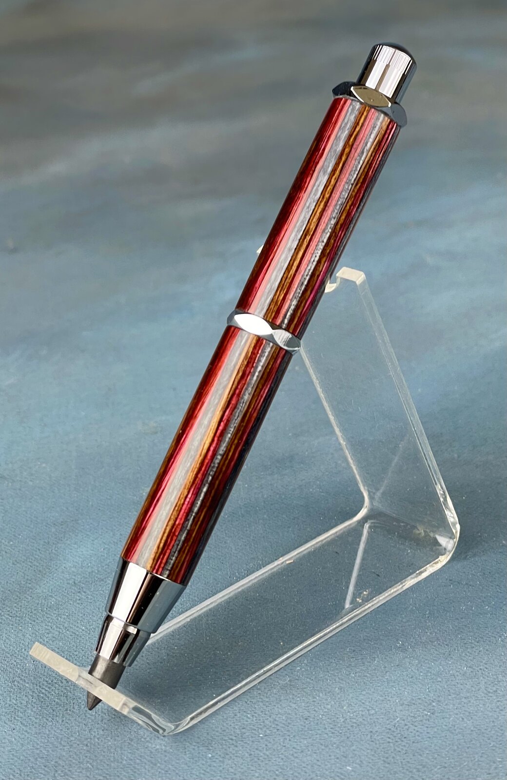

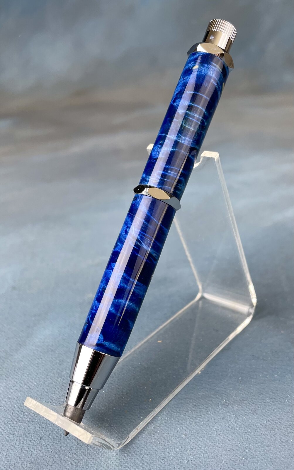

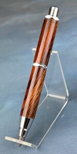

Three sketch or shop pencils finished up today after shipping the tackle box. Peruvian rosewood, spectraply and blue box elder burl aka starry starry night.

VERY nice work, Mark ! ! ! !
I'd be interested to know how well your customers respond to these .
So far I've made six and until today I was out of stock. The plan is five on display though two seem to be sold already. I'll order more.
As a side note: the instructions say drill a 13/32" hole. The tube did not fit any of the ten holes drilled as directed. I ended up with 7/16". Go figure.
