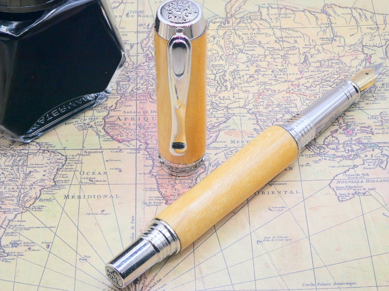

Hello, I have several questions for you which I hope you can answer:
For how long have you been in this hobby/business of pen turning? Did you have any past experience in the woodworking field? How long did it take you to consistently produce quality pens?
It seems to me that every time I turn a pen, I do a small error at a certain stage, spoiling the entire work... Although I have a small shaking problem with my hands, and the conditions at the community workshop I work in are less than optimal, I still feel very frustrated when something goes wrong, and it usually goes that way. Of course, I still enjoy pen turning, that's why I'm here :)
I did hope however that you could give me a certain time frame of how long did it take you to sort of "master" this craft... I'm about six months in with no previous experience in woodworking. Thanks!

@Amihai
Hmmm . . . you show a picture. . . It's presumably a picture of a pen that you recently turned.
I don't see any fault with that pen. . .
Is there a fault ? . . You do not refer to that picture in your post .
Were you meaning to show, and explain what you are showing . . . in the text of your post ? . . . using the picture as an example of what you are talking about ?

As Mal said, your pen looks good!

@Amihai
Well, it's not really visible from the picture, but I forgot to sand down the CA remains after finishing... So it didn't align very well during assembly.

Like any endeavor, "mastery" could take a lifetime,and like any endeavor it can be taken to any degree of complexity or simplicity you desire.
If you were both an experienced woodturner and woodworker you could achieve a good level of competence after a very small number of pens.
With no experience in woodworking, instruction from an experienced person would speed up your understanding,and joining a forum such ad this where there is a wealth of knowledge and kind encouragement.
Knowing what can go wrong helps in preventing someting going wrong.Having a clear idea of the sequence to achieving the end result is also required.
What I can see is grain break out at the base of your cap,mainly to the right of the clip,cause unknown,but there are short grains with tearout visible in that area,the grain in the wood is also showing this would be an area to be wary of.This could be turning technique or blank trimming process. There's also "bleed" visible on all blank ends which is most likely from sanding in micro metallic particles from your bushings.
So,no you don't suck,and we all learn at our rate.

@Amihai
Well, that does NOT mean you suck at pen turning . . . . EVERYBODY IS TELLING YOU THE SAME THING !
You simply FORGOT to do something. .
You have made good progress to get where you are ! !
Keep at it ! ! ! ! :D . :D . :D

The pen looks pretty good except the ends. It is difficult to do good work unless you have good tools. How are you squaring the ends before turning? Do you have a way to sand the ends square after finishing? There is usually some CA slop that needs to be addressed. Attention to detail and taking your time on assembly are key. Several times I have had to disassemble because I wasn't paying attention and didn't notice something or wasn't happy with some other aspect. Get some wearable magnifying glasses. It will help you see mistakes. I wear them when I am doing my final turning to get the ends to match perfectly with what my calipers are showing for the mating part. I don't make pens without using my calipers. It also looks like you are slightly under turned on the ends. Calipers will fix that. Bushings just get you close. Don't worry about hitting the bushings. All of mine have been shaved a little. :rolleyes:
I have been turning for 10 years. First pen was done with a teacher and came out very good. My wife still uses it and I could not improve it today. The next dozen pens were done on a friend's lathe and I was pleased with all of them and still am. My finishing and finishing materials has improved over the years, went from CA to GluBoost, but the turning was fine. I did have about 50 years of woodworking experience prior to that. When I started, I read about 4 or 5 years worth of prior posts on IAP and learned every trick and suggestion I could find. There are a lot of REALLY experienced guys on here and every question has been asked and answered dozens of times. I probably made 5-6 pens before I started selling them and only have my first 3 left and they are not for sale. I was into segmenting early on because of what I saw on here and that prompted me to careful in my turning and get good fast.
10 years later I still make mistakes, but I have gotten really good at fixing them! I still have to punch out the hardware and correct something on occasion. The pen I just finished had a slight blowout on drilling. I thought I had it blocked solidly but something went wrong. I fixed it and saved the blank, but it took some time to make it disappear.
I would say for 6 months on borrowed equipment you are doing pretty good. That pen is close to 100%. Most people would not see any flaws. If you see them and know what you did wrong, you are well on your way. If you aren't turning 1 or 2 pens a week it is hard to maintain the consistency to make it all the way without some mistake. If you are having fun and learning on here, you are doing the right things. Keep turning!

I think you are being hard on yourself unnecessarily. If the photo you posted is an example of your work, I think you did a great job. Turning, like any other skill is a constant learning experience. I've been doing it over 30 years and I'm still learning. Best advice I can give is to take it slow. It's a relaxing activity, not a rush to the finish.

From what I can tell you may be turning your pens into an oval shape. Caused mostly by a bent mandrel rod. It's hard to correct for this. I've tried straightening the rods by marking them and then hitting them with a hammer but in my opinion that doesn't work well. Turning one blank at a time with a PsI pass through tail stock helps with this quite a bit but I've had the most success finishing between centers. Everything can be corrected, it just takes some practice and maybe Trying some new techniques
