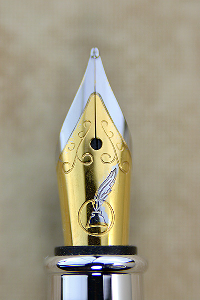

But let's get back to the question - "is a macro lens necessary for pen photography?". I'm going to be contrary and say "no". I don't have any trouble filling the frame with a non-macro lens. Using an APS-C format camera and a 28-135mm zoom lens, I can shoot comfortably from about two feet away. That yields a perspective similar to holding a pen at arms length.
Unless you want to take extreme close-up pictures, you don't need a macro lens. I don't even own a macro lens (at the moment), but I was able to take this picture using a zoom lens set to 70mm and an extention tube. It is on the verge of 1:1 magnification.
attachment.php
I did not crop the photo at all, so I could print an 11"x17" enlargement from the full-resolution version. If that's what you want to do, then I'd recommend a macro lens. If you just want to take regular pen photos, then one isn't necessary.

Extention tubes will reduce both the minimum and maximum focus distance. That is, you can move the camera nearer to the subject (thus yielding greater magnification), but you won't be able to focus to infinity anymore.
They also reduce the amount of light that reaches the focal plane, so you'll have to increase the exposure (larger aperture and/or longer shutter time).
Any defects the lens has will be magnified. Depending on the sensor size, tube construction, and other factors, you may see some vignetting.
If the tubes don't pass the lens's electrical contacts along, then you may lose the ability to control the lens aperture (if it cannot be manually set). Depth of field is already very short, and if you have to run the lens wide open, it will be miniscule. You'll also lose auto-focus (although you might have to focus manually anyway).
