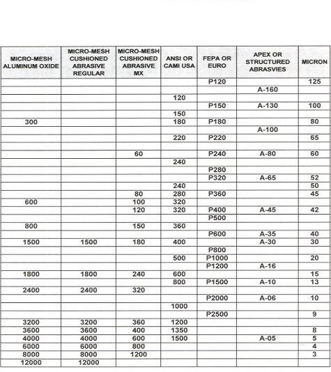

I also see a lot of references to finishing with MM. I assume this is Micromesh. I am confused by the various grits of MM. Is the mm12000 on the same type of scale as grits as a typical sheet of sandpaper.

Yes, MM is Micromesh. Great stuff, and no it's not rated on the same scale as sandpaper. There is a chart somewhere that compares them, but I can't remember where offhand. Maybe someone will point it out to you. 12000MM is the approximate equivalent to 4000 grit sandpaper if memory serves.

MM is micromesh sandpaper. the grits start about 1200 grit and finish at 12000 grit.
do a search for this topic to see what the grits will convert over to regular sandpaper.

Here is the chart for MM to Sand paper reference
