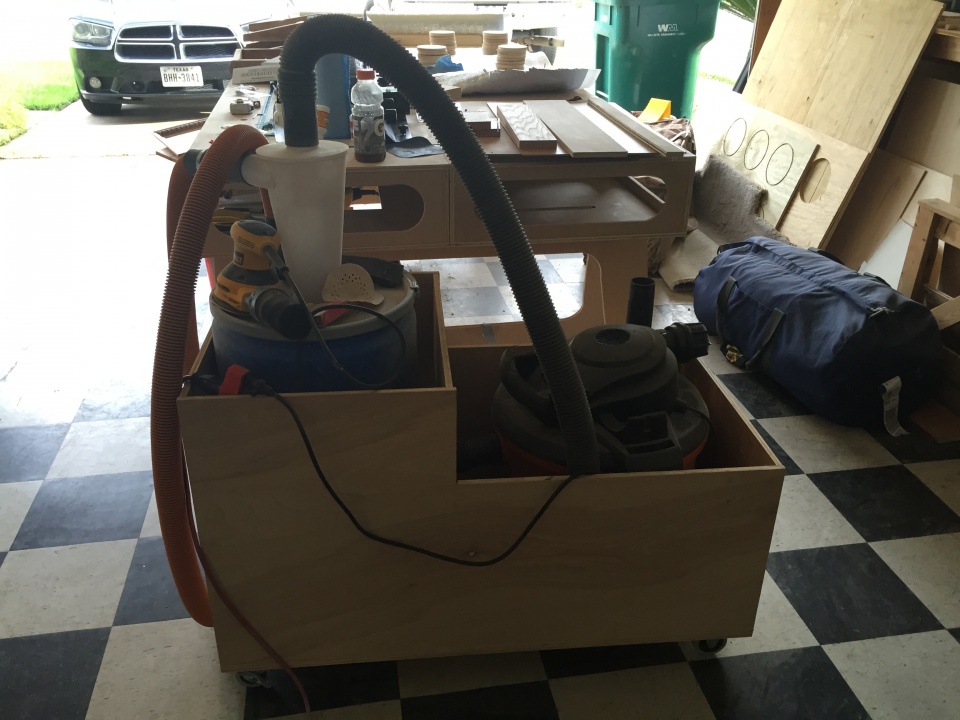

This is my dust collection system. I purchased a shop vac from a big box store, a drum from Amazon, and the dust deputy. After realizing dragging the two around didn't work very well, I decided to build a cart.

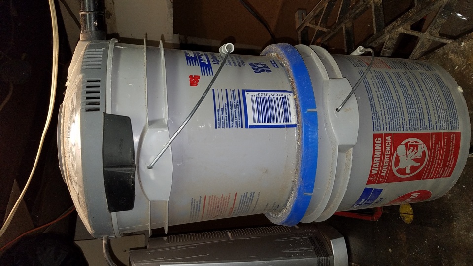

I'm in flux right now I have a generic Dust deputy attached to a 5 gallon bucket and a bucket head on top of a Matthias Wendel's home made 2 bucket cyclone .
Plan is to maybe use the two bucket cyclone under my lathe bench sucking the dust down through a hole in the bench using 2" PVC.
Either way I'm going to remove the filter from the vac and just send the fine dust out through a hole in the outside door.

I bought a 2-tier metal cart at Harbor Freight... 16" x 30" ... Red enameled. My idea is to see if I can mount my Dust Deputy and the Shop-Vac I got 2 months ago on top (with a hole cut through the top "shelf" for the DD) and mount a bucket underneath that locks into place with a good seal directly under the DD ... I'ld probably re-use some type of bucket lid in order to get the best seal I could. The DD on top and the lid on bottom would be sealed all round with silicone gel.
The other half of the bottom shelf would be where I could store additional hoses, attachments, ect... But when I get my shop built, I'll build a large cabinet with some sound insulating materials where I can keep the entire unit and have it near my lathe, as that generates the majority of my dust and wood shavings.
I do plan to run a line over to my table saw too, if can ever get that thing out of the box, lol ... and the bandsaw and 4"x36" belt sander as well. Those are my really dusty work areas. I'm waiting for some connectors and a hose that I ordered so that I can put this DC to work dedicated to my lathe, at the moment. Also waiting on the bucket.

Well after not being in my shop for months I have some expected late Xmas presents to make so I got a heater going in my shop as we speak and should be down there soon.

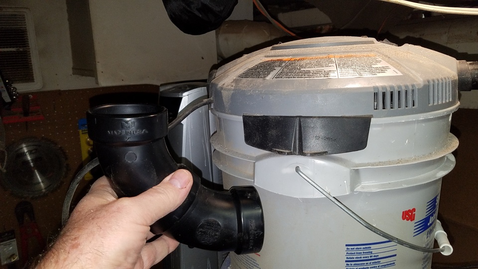

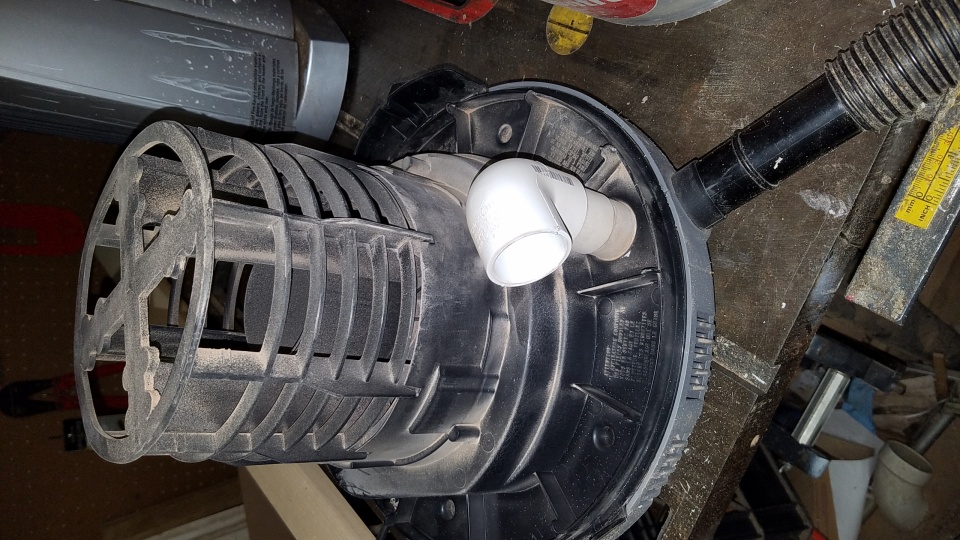

Haven't done much testing but it works way way better than expected. Without a filter I've tried sucking up fine dust and I see nothing coming out the exhaust.
The current Issue I have is that the inlet is just way too small. I think its more like 1" vs the normal 1.25" and anything more than dust clogs it up since it also has a sharp 90 into the bucket and then another to get the air moving around.
I plan on making an inlet just like Matthias's with 2" pipe and long bend pipe fittings and plugging up the inlet.
I'll be back.

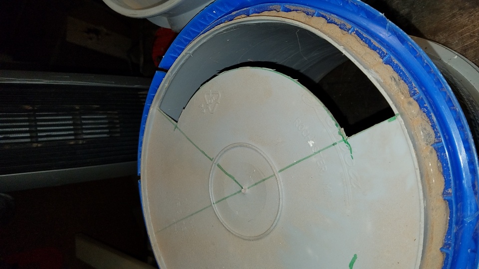

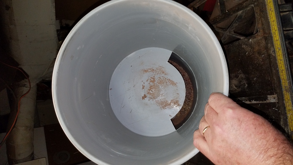

Here it is. I think I got the idea of using two buckets this way from another video. At the time I didn't have any gal buckets. But now have one so I'll probably use a gal for the bottom. Also need a better way to hold them together to make easier to empty it. Probably get some sort of latches.
its should say 5 gal buckets. my 5 on my keyboard not in the num pad is broken.
But wanted to add the person I got the "Plans" for had a specific reason for the size of the baffle. You can see my cyphoring layout.
