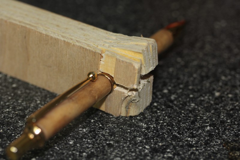

I have a trick for disassembling pens when punches won't work.
I use a piece of plywood. Drill a hole about 1/2" from the end. Drill it to the same size as the center band, it's better to have a too small hole, than a too big one. Then cut a slot, I use a band saw from the edge to the hole. Press in the piece, and then clamp it in a vice. If the piece is too hard to hold, wrap it with tape. I use medical compression tape, that is like an ace bandage. Pull, wiggle, swear and get mad at me for suggesting it, then the piece will pull off!
Attaching pic of old pencil I just re-finished. It was a pain to get the centerband off.
