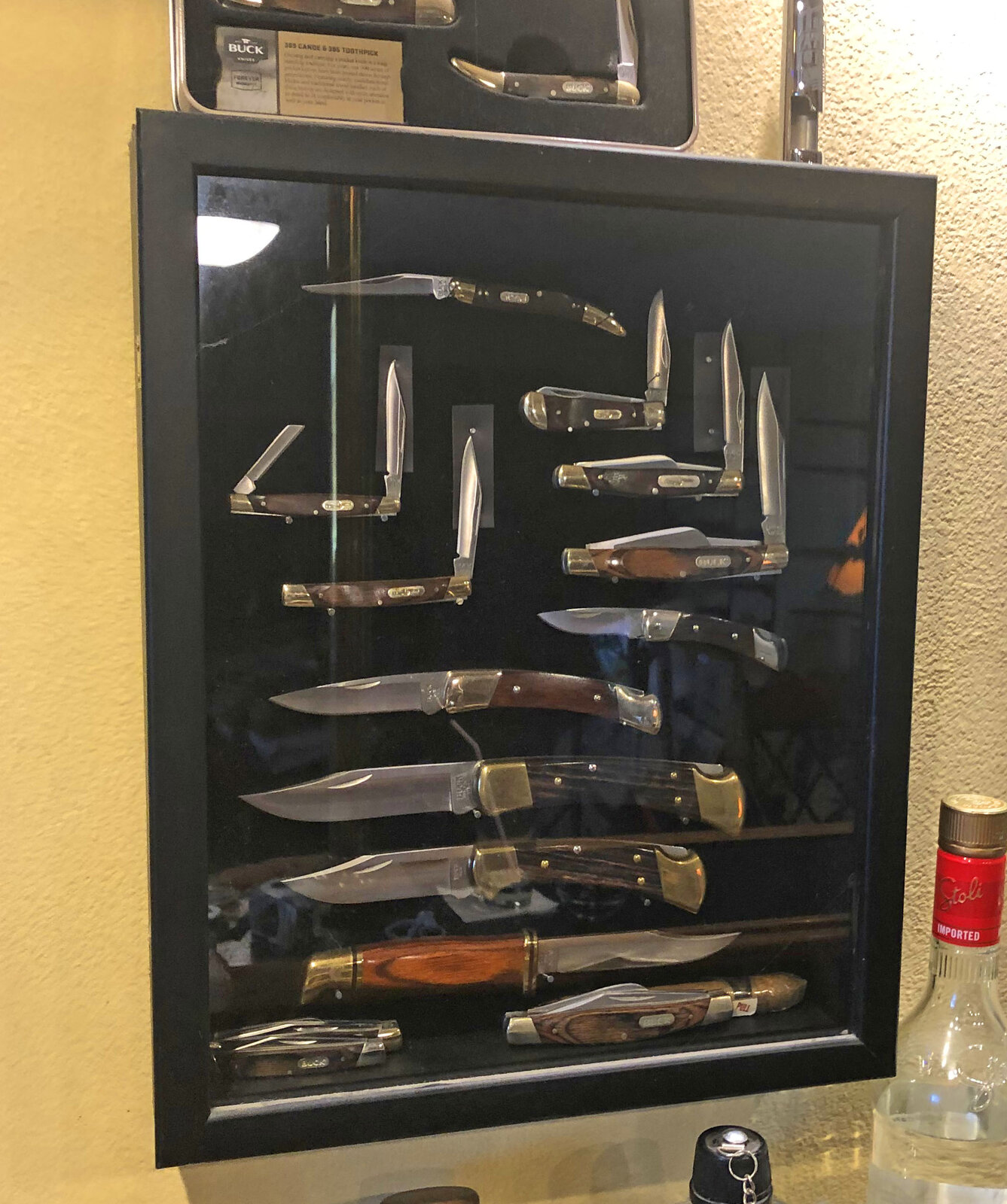

I have made a couple of display boxes, one for pens and one for a knife collection.
I purchased 11x14 Picture Frames with thin black wooden frames. I also purchased some 1/2-inch by 2-inch poplar boards from the wood moulding section of our local Menards. For the back, I used some 3/4-inch rigid foam insulation that I cut down to the appropriate size and covered with a black velvet-like fabric.
Using these materials along with a couple of small hinges, a couple of screws, and a small neodymium magnet, I painted the boards and used glue and brads to build a kind of shadow box, attaching the picture frame with the hinges and a closure using the magnet and a small steel screw.
The knives and pens are arranged and suspended using small head sewing type pins that are simply pushed into the foam backing.
Sorry I don't have better pictures but at the moment both the pen and knife displays are packed up in moving boxes. Here is a snapshot that I took of the knife display as a reference before packing it up.
All in all it was fairly inexpensive and didn't require a lot of tools or time to complete.

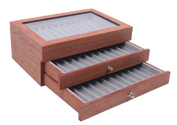

PS I also use some relatively inexpensive (about $40 bucks) Faux Rosewood Pen Display Cases that I bought from eBay. They are essentially a hinged top glass covered space and two drawers with slots made to hold pens. Not bad for something inexpensive.

I've seen pen display cases like this one on Amazon, Dave.
I'm pretty sure I couldn't make one for what they are asking.

Actually, I was a little surprised at the quality - I didn't expect much for $40, but they actually don't look too bad even with the faux rosewood finish on the wood. I have 4 of them all together. The interior slots are kind of a beige or tan color and feel soft, like some kind of flocking would feel. The top row has 12 slots and each of the drawers have 11. The faux finish is a reddish brown rosewood color with some "burl-ish" looking eyes on it. I'm pretty happy with them anyway.
The ones I have all have 2 drawers, plus the top = 34 pen slots. I have also seen the same design with just the top glass part (12 slots) and with one drawer (23 slots). - Dave

Do you remember the link? Do they sell these?
Thanks I found the links and man there is a ton of them. Need to look through this. Question for you, do you say that a full sized Majestic rollerball pen would fit nicely in those slots?? Tough to tell the size of the slots from photos. Thanks.
I haven't made a full sized Majestic before, but I just stuck in a round pen blank that is 3/4-inches in diameter and a little over 6-inches long in one of the drawers in mine and it fit - just barely, but it did fit and the drawer did close. So, my guess is yes, a full sized Majestic should fit. - Dave

Love your Buck knives collection, you inspired me to make a similar case to display them. Its a pity to keep them away in the closet.

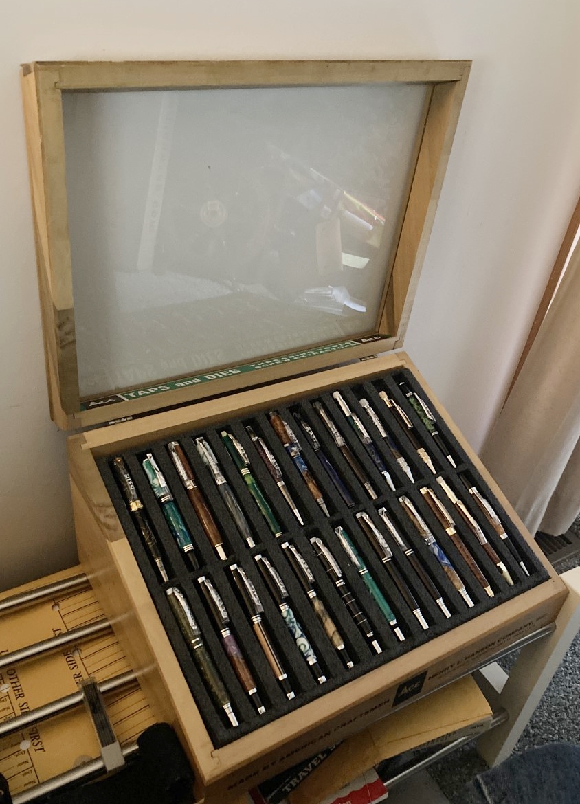

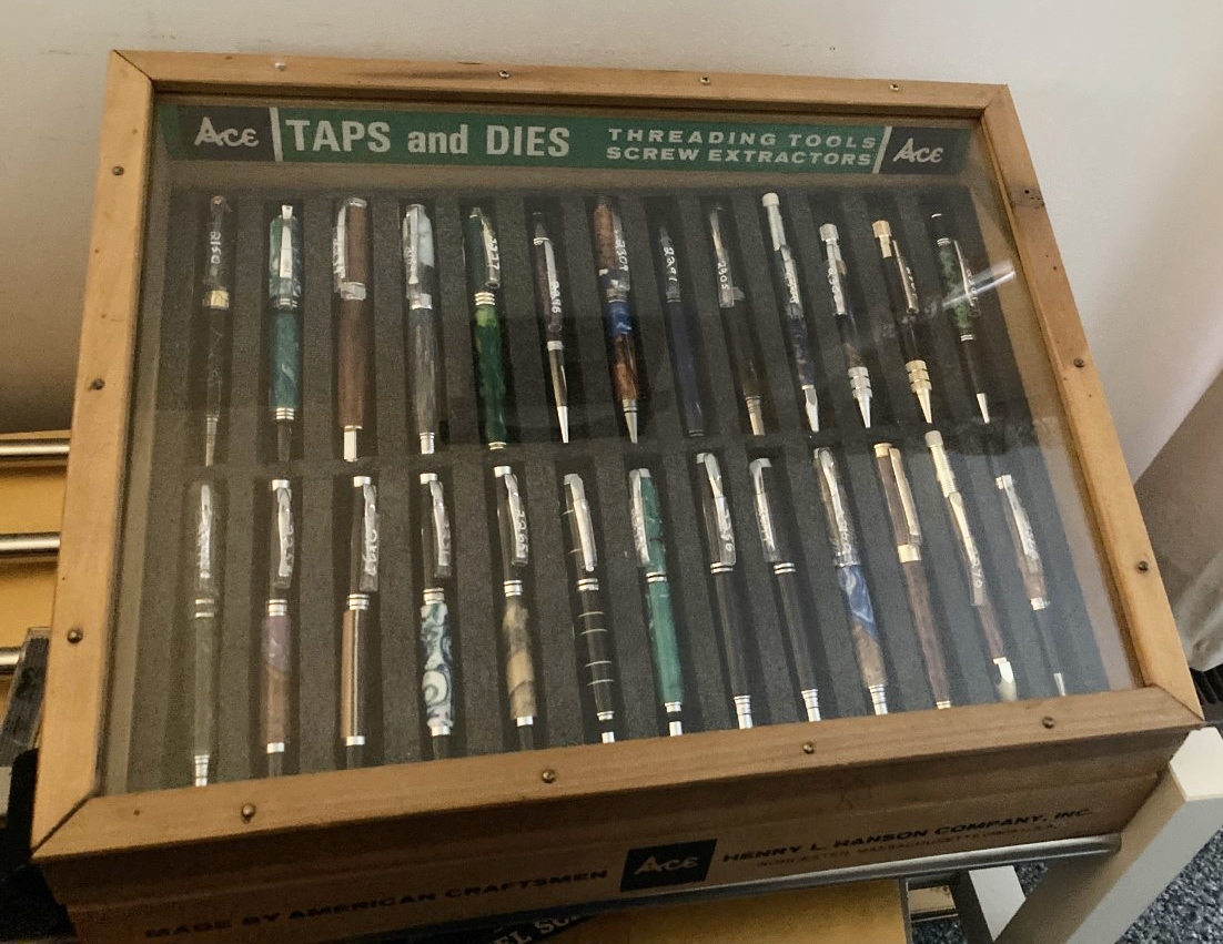

A friend of mine gave me an old Tap & Die display case from the 1960s - I removed the inserts that were in the case, and made a pen insert using foam that you cut out the profile on. This is where I store my favorite pens. Most of my other pens are stored out of sight in a carry case that can double as a display.
Thanks, I just wish more of them were USA manufactured, but they were pretty hard to come by when I started collecting. - Dave
I bought most of my knives at the 90's when buck was a high quality brand. I remember i was working during summer to raise money to buy a buckmaster; i haven't use it since but i still love it. Maybe a nice handmade case is in order.

What a cool display case.

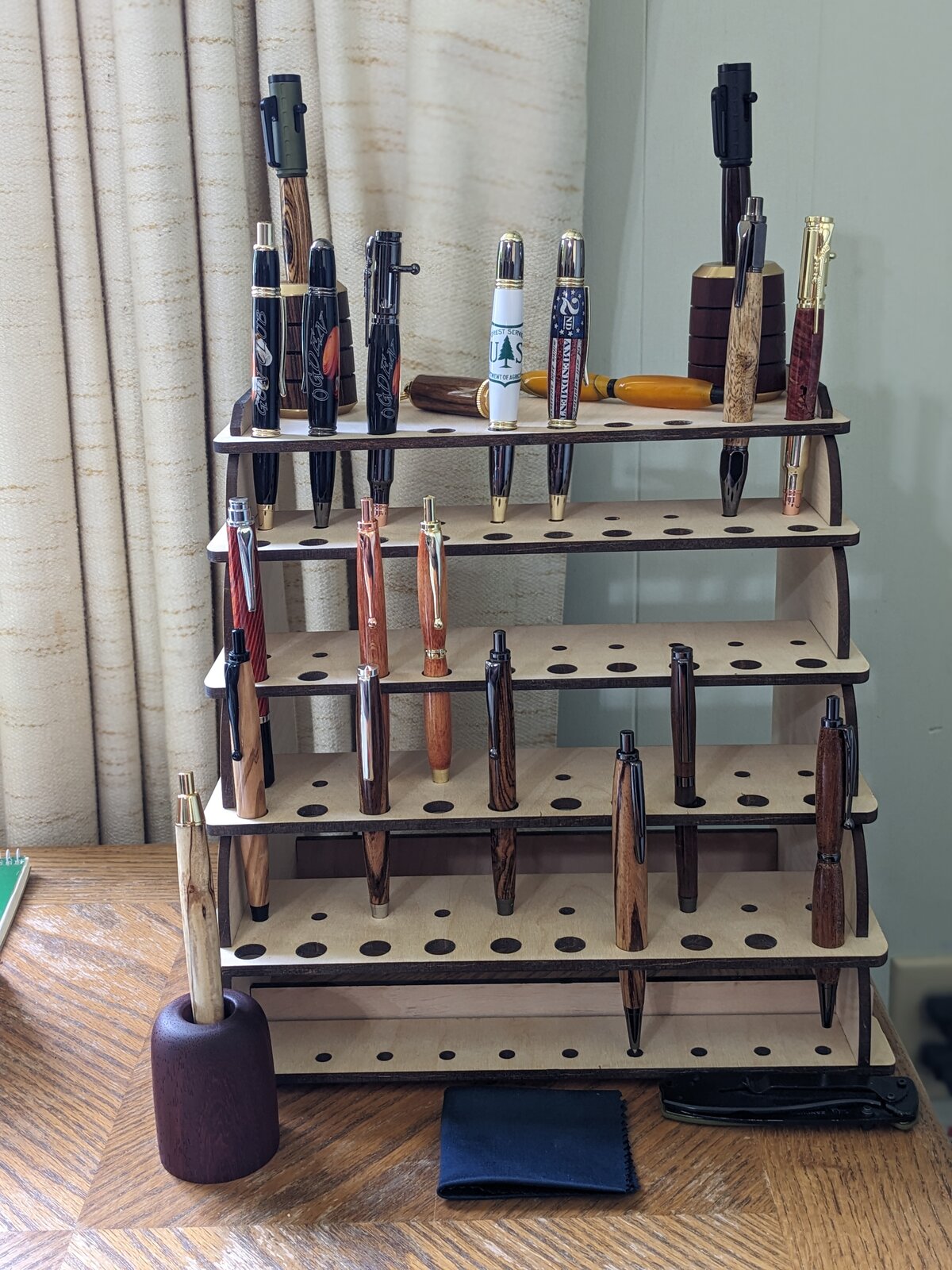

I just got this stand off Etsy for about $50 with shipping and tax. It's not perfect but I don't think I could make it myself for the price not to mention the time it would take to drill all them holes.
Now to round up the writing sticks.
