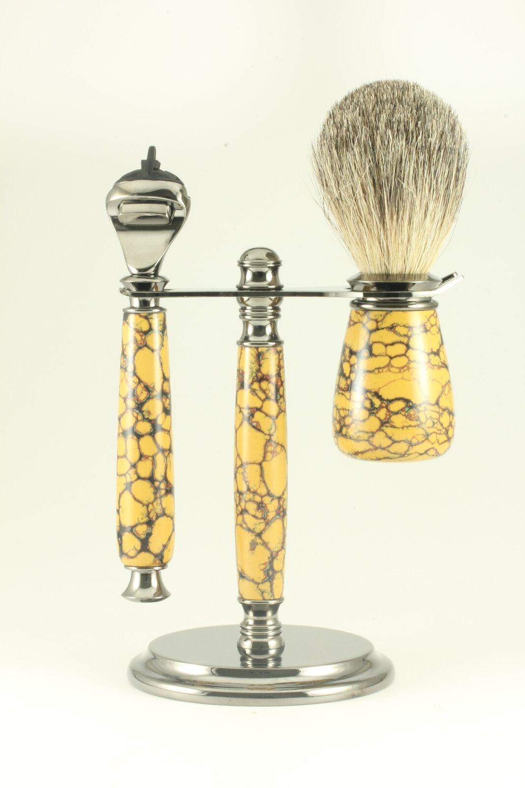

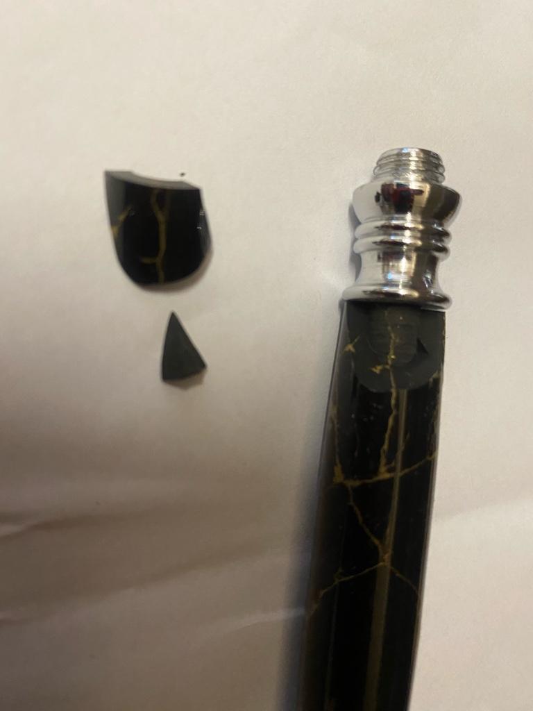

I made a shaving set for someone a while ago, they knocked it off the shelf and broke a chunk out of it.
How do you dismantle the stem without damaging it any more?

I would disassemble it the same as a pen, using the steel center finding set from Harbor Freight. Then turn a new barrel, or turn off part of the existing blank and insert a piece where it is broken. Might put one at each end for a more balanced appearance.
Tom

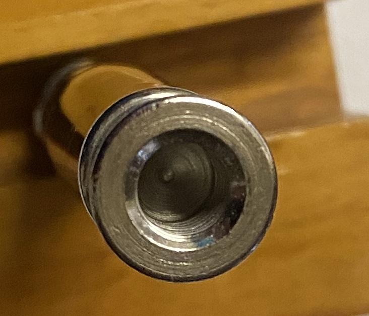

The pieces are held in with an friction fit, so if you can hold it without marring the surface, they can be pulled apart. You may have to twist some to get them to loosen up. Once it is time to put it back together, use some glue to hold them together. Don't use super glue, if it gets on the barrel it will demolish the finish. Use epoxy, which can be cleaned up with alcohol, without damaging most finishes.

Clamp the barrel in the soft jaws and grab the insert with the pliers, and tap the pliers with a hammer to remove the insert.
I like using the pennstate assembly/disassembly press. Prior to owning one, I used to wrap compression tape around the body. You can get it a drug stores. Then I hold the body in my hand, put a transfer punch (round rod) inside and a hammer. Hope I don' miss and hammer my hand.
