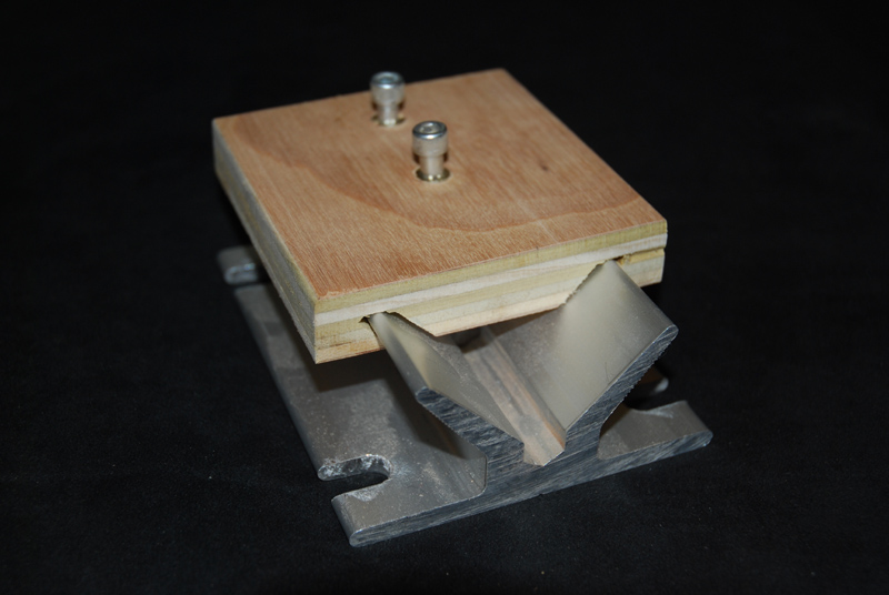

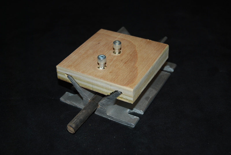

I'm not a fan of pen mills, and I've been fiddling around with easy to change-over squaring jigs for the sander. I saw this pipe drilling jig at Eastwood, and thought I'd give it a try.
Wanted something extruded, with a "V" groove built in, with sides parallel to the groove. Made the simple plywood top piece in a few minutes, use my transfer punches and viola! Simple, cheap and effective so far.
-gary

Yes, I clamp onto the transfer punch.
And yes, I use a miter gauge to square it to the sander. Every blank I've squared with this so far is dead on square. Coming out better than I've ever done with a pen mill or any other jig I've tried. And quick!
-gary
Just noticed that I posted two of the same pics. Meant to show it from both ends. 2nd time today I did that.
Here's the pic that shows the other end.
-gary

I understand now. I went a similar route using a wood block with a V cut and a Destako clamp screwed to the block as a hold down. It made the pen mill obsolete. :)
If you clamp a blank in a "V" block that is not perfectly square and parallel along its length with the tube hole perfectly drilled through it, it will not be square. With the blank on a transfer punch it will sand a square end no mater what the shape of the blank. Think how you would do an antler by holding the outside rather than the axis of the tube.
I had tried the "v" groove in a block of wood, but could never get it all quite as square as this aluminum extrusion.
