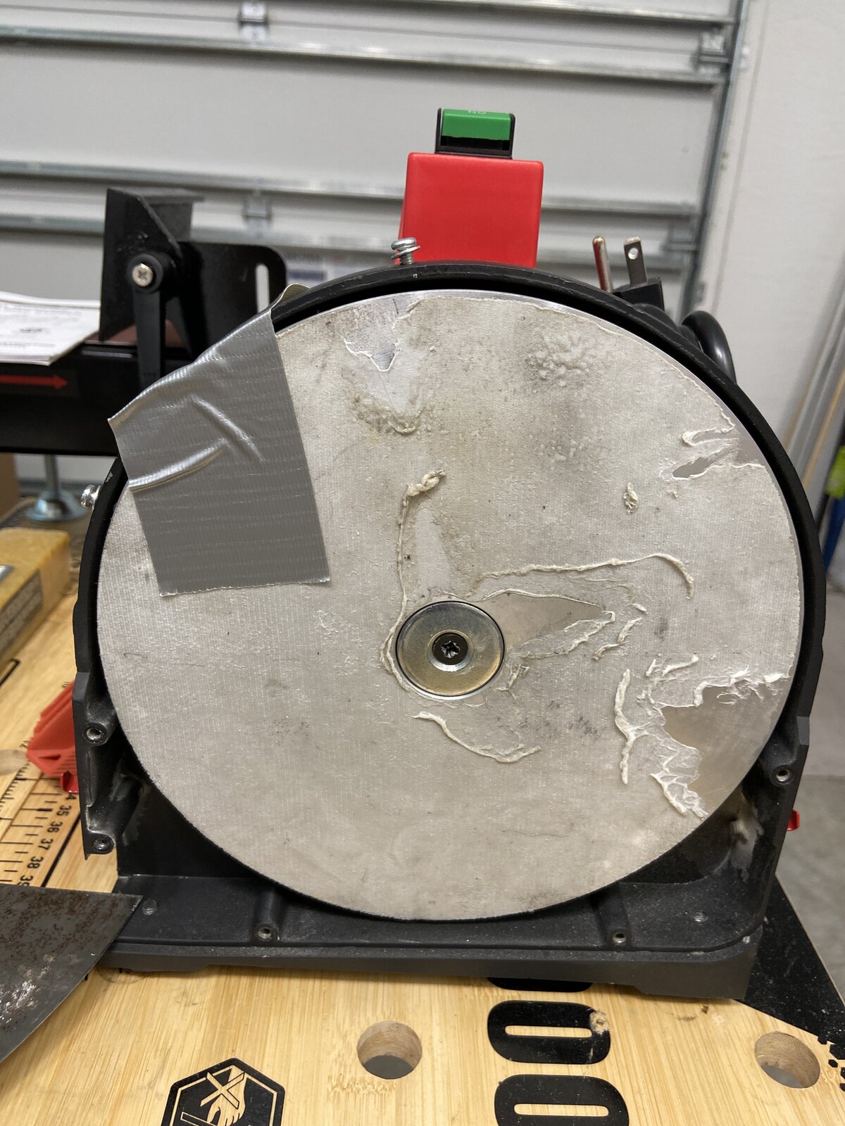

Maybe I should have tried the hook/loop before trying to covert. Possible remorse here. Trying to remove the adhesive from the metal disc is nuts. I tried a small dab of mineral spirits and it stinks. Immediate headache … and that's with the garage door open. If ever again … outdoors with a respirator.

Wow I can not believe the horror with stick on adhesive paper. Frank what you did wrong. The adhesive stayed on the platen but came off the paper. That is why the mess. You need to try to take both off at the same time and that requires some heat and work slowly it will peel off. If the paper stays on adhesive you then have something stronger to pull on. You get under the adhesive in a corner just heat or add some acetone as you pull. again try to keep adhesive and pad together when doing this.
Just a few tips for you sander people. If you are pulling the paper off and it keeps falling back and sticking on the platen, just use some baby powder to sprinkle in back as you peel It will prevent from sticking again. That is an old woodworkers trick. Next is when you get the platen cleaned make sure you clean it with acetone. That is what I found the best to clean glue such as that and epoxy glues. Let dry before you put next sheet on. You all would be complaining if the pad kept coming unglued while sanding so look on the bright side.
Next tip and this one is important. Do not overbuy sanding belts or adhesive backed pads. The glue drys out and the belts will break at the seam and the pads will delaminate at the adhesive as you see. The longer that adhesive weather it is tape or stick on glue is stuck to one place the harder it is to come off. Thus when painting rooms and taping off woodwork and things remove as soon as possible.
One other tip is use good quality paper.
Now I never tried this but maybe worth a try. Use a very light coat of wax on the platen before adding the pad. If you do try let us all know how it works out.
