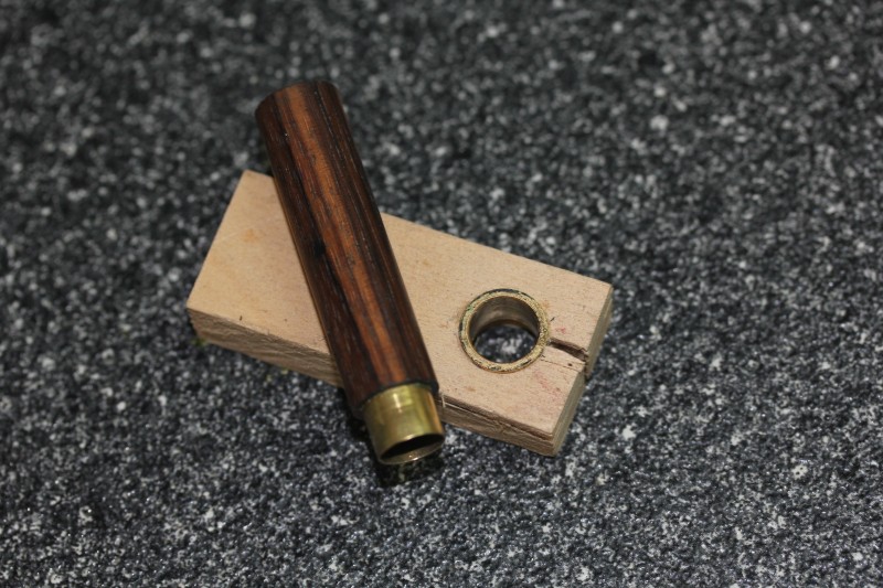

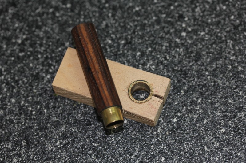

I came up with a great (IMHO) solution.
Drill a hole the same diameter as the centerband into a piece of scrap wood. I used 1/2 baltic birch. With a bandsaw, cut a relief slit.
I then had to coerce the centerband into the snug hole with a vice. Then held the piece tightly in the vice such that the vice pressure clamped the centerband. After some tugging, the tube separated. Since the centerband was clamped evenly with relatively soft wood, the band is not damaged!
Now I can refinish the body with CA! BTW, these are 15-20 year old pens originally finished with Hut (shellac/wax/mineral spirits?)
Have a great 4th.
