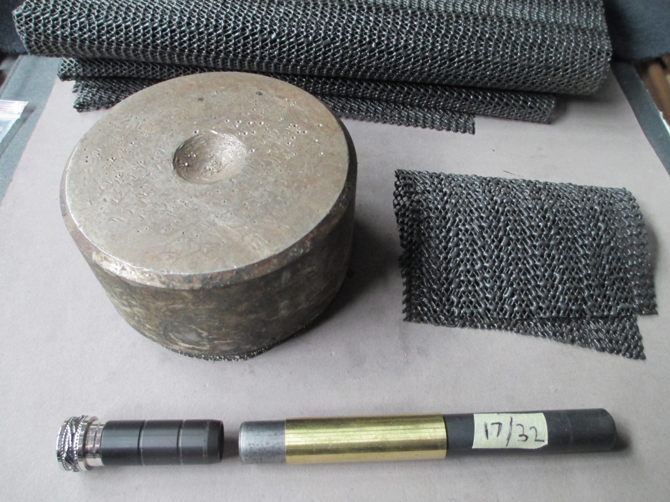

If you're just gripping the pen barrel with your bare hands and hitting a center punch with a hammer it will be very hard, you can get a much better grip on a pen barrel when using a Rubber Grip Mat and use a steel block on you work bench to hit the punch against.The Majestic are a really over tight fitting i sand the brass tube down a tad and use smear of vaseline on the black plastic tube before pushing it into the brass tube this stops the problems your having.the photo of Rubber grip matt
