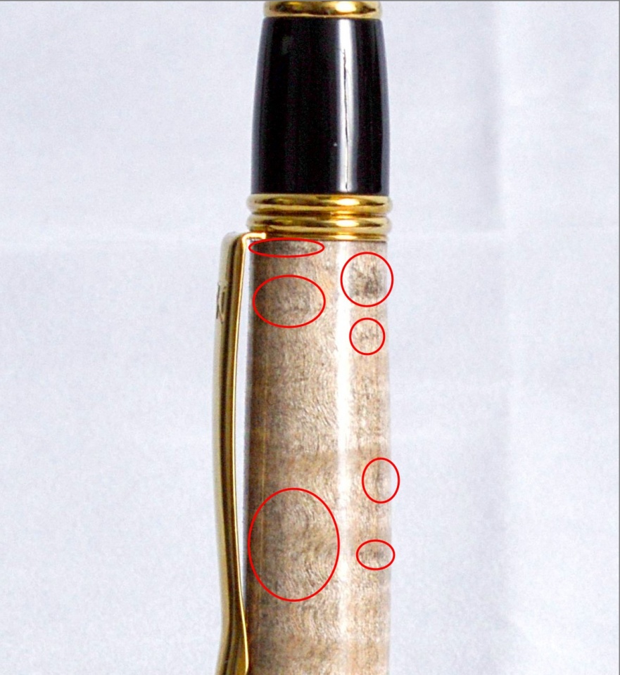

Thanks everyone for the replies and tips - Here's an image of what I'm seeing. This is a relatively minor example; I've seen it worse and I've scrapped a couple of blanks and started over. I highlighted the main areas, but I can see the "dirty dust" is more or less over the entire finish.
Joel

I think some of that is simply variation in the grain of the wood...i hav run across similar problems...:confused:

You may be right, but this is not the piece of curly maple I started with; It was pristine prior to sanding, and it sure doesn't look like most curly maple pens I've admired...:confused:

Joel that is grain variations especially with curly maple because that is what makes it curly looking. When you are sanding basically you can never sand with the grain because it varies. remember you are working with a small piece of timber and you have turned it down even more so it will not look the same as in the raw. When you start your sanding with such a coarse grit you open the pores and are asking for trouble with contamination from the metal bushings. never any need to start with anything less that 220 grit.
For me I am a big proponent for never touching the blank with sandpaper before the first coat of finish. learn to use the skew properly and you will not need sandpaper. I do segmenting work and cross contamination from different colored woods is a huge problem and I solve that with never using sandpaper. Just my skew. Just an opinion.

Thank you for your response. I'm developing better "skew skills" every day, but have continued my (apparently aggressive) sanding practices. What you say makes perfect sense. I would assume that it's also true of burl or any other-than-straight grain. I'll keep trying... :redface:
"More skew, less grit... more skew, less grit. Repeat"

One other possibility that sometimes happens: If CA is applied and then it is sanded through in spots, then wiped with a cleaner, the spots will darken even when CAed over.
Using a wiping cloth that has metal dust from the bushings will do this, and it becomes more prevalent if wiped after sanding through in spots after the initial CA application.

Ran to the woodcraft store today and picked up some hold-fast bushings. Ordered some abralon online and moved all less-than-320-grit sandpaper a minimum of 15 ft away from my lathe station :). Turned a few trinkets using a gouge to start and then picking up my skew earlier than usual. Turned out fantastic. No "dirty dust" and the hold-fast bushings are great!
Now, to work on that CA finish... :redface:
Thanks to you all for your feedback and advice. I continue to be in awe of the wealth of knowledge and spirit of support here.
