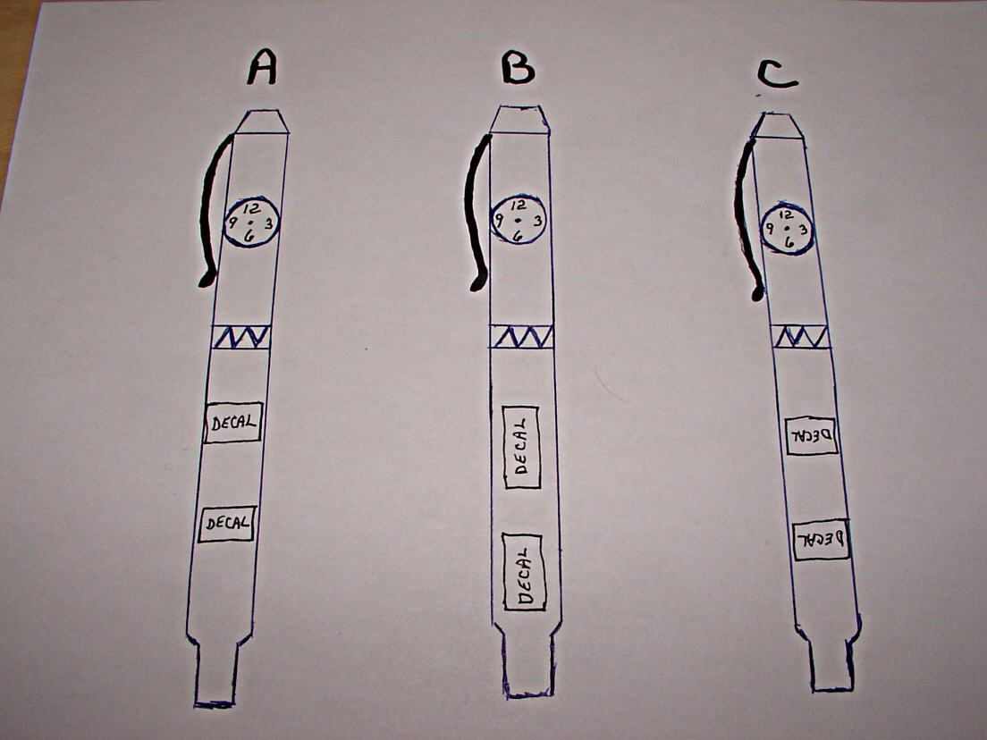

I am sure many are asking what in the world is he asking now? Well you do not see this much here so thought I would throw it out there and ask for examples if you have them. When casting items that have sort of a top and bottom to it or correct facing and upside down facing as you may. When casting in a two part kit and you cast the object on the nib section of the pen, do you cast the top facing the nib or the cap portion? Now say you are casting something that has direction in both the cap and the lower barrel of the pen, do you face both the same way or face the tops looking at each other? For example sake in case you are not following, You want to cast a watch face in both the cap section and the lower nib section, which way do you face the dials. I assume the cap is always top gets the 12. It is the nib section that the decision has to be made. This can be other things and not just watch dials. Take label casting and you use face or objects that have direction. Which way do you face the lower barrel item. ?? Thanks for playing along and would like to see examples. I ask because you have to think. When pen is closed you look at it one way but when you open to write with you look at pen a different way. I am sure there is no right or wrong way but a personal preference and would interested in seeing the consensus. Thanks.

This is an old photo that I found I did many years ago here because I think I asked this question when I first started pen making. But I think we are combining 2 different questions but that is good also. My question here deals with photo "A" and "C" . On a 2 part pen like most rollerballs you want to put items in both the cap and the lower barrel. These parts have a top and bottom to them such as a clock face 12 being top and 6 being bottom. (As I said a decal can be used instead of a clockface) When the pen is closed and displayed or if someone picks it up to look at it they usually hold it with the cap up. If you use photo "A" the decals look right to the eye. But when you go to write with it and take it out of the cap the decals are now facing upside down as you write and those looking at the will hold it with the nib pointing down. The opposite of all this happens with photo "C" Weather you are right handed or not does not come into play with this part of the question.
But being right handed or left handed does come into play when using decals or other directional objects in Photo "B" because now you are looking at pen from the side or center. Then what Dogcatcher says about reading from left to right can play a part in the decision.
Hope this clears up the query somewhat. I tried looking for my very old thread on this but had no luck. I will look some more and see what we said back then. Thanks again everyone for your thoughts.

I always orient the castings toward the cap with the pen closed. That means the castings for the body would be oriented toward the nib. I also believe the castings should be consistent between both the Cap and Body which would be example A in your diagram.
The square part on the bottom of my pens is not the nib. Those pens represent a closed 2 part pen.

A. Displays best
B. Okay
C. Does not look right
