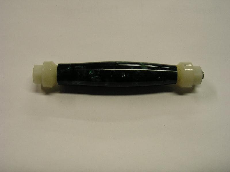

Anyways, I'm only a few months and 60-70 pens into the insanity. Have tried friction polish (C-grade), CA (B+ and getting better now that I'm buffing), but wanted to try lacquer or poly. Sprays are too likely to kill what few cells remain, explode the garage, or do other nasty things.
So I've tried dipping, didn't like wire, hanging, plugging, etc. so I went to Lowe's and assembled (at great expense) parts needed to make "The Little Dipper" (tm applied for).
Basically, it's a rod with bushings and nuts to keep out the liquid. I turned a slope on the bushings to fit inside the tubes. Procedure: Open can of lacquer, dip, drain for a minute, and sit the end of the dipper into a 1/2" hole drilled into a piece of scrap. Close can...go back to work turning. Repeat 1 or 2 times, until satisfied. After letting it cure a day, remove from fixture, trim small amount of residue from ends of blanks, let it cure some more as desired, buff and assemble.

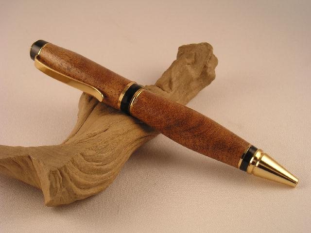

I was so satisfied with my first pen that I assembled it without pausing to take photos. So the photo is with a piece of acrylic standing in for real wood. Below that is a photo of the mesquite that was dipped and assembled into a cigar pen. As Tom (Griz) has said before, the finish is only as good as the sanding. I took the blanks to 12000mm and the finish is silky smooth.
I have been thinking about offering "The Little Dipper" (tm applied for)for sale and have priced out the components utilizing a 6" rod instead of the 4" rod shown. A set of 4 could sell for $5.+ shipping and barely compensate me for my time. Do you think there are enough other "secret dippers" out there to make it worth the effort? If so, I'll post it in the proper place.
Joe

Warning, danger, Will Robinson. Sorry, I couldn't resist. One word of caution using Joe's setup. Joe, it looks much like what I use, but it is extremely important to make sure that the "bushings" that you use at both ends of the barrel are as close to the finished size of the barrel as possible. Otherwise the dipping solution will not run smoothly dowh the length of the assembly and result in a built up bulge of finish at the ends (worse at the bottom). DAMHIKT BTW, I use Deft Gloss straight from Lowe's and unthinned. Everyone has their own technique and preferred material. None are more right than any other and what works for me, may not work as well for you, etc. Once you hit on something you are satisfied with, you'll stick to it.
BTW, there is a thread containing a photo of the setup I used posted on here somewhere, but here is the photo again.

Dont take this the wrong way. Joe, there's not much of a shine going on with that cigar, especially for a lacquer dip. Billy's is a good deal more glossy. I don’t know if it's your lighting or what. It's probably a lighting problem. No offence meant, just something I noticed.
