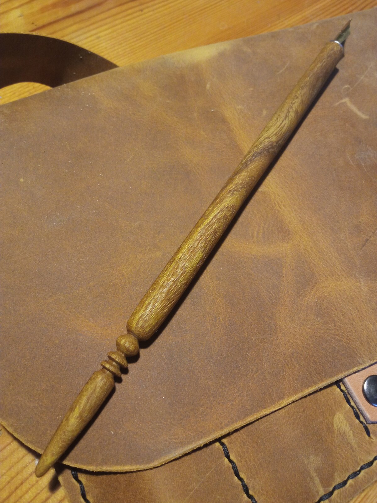

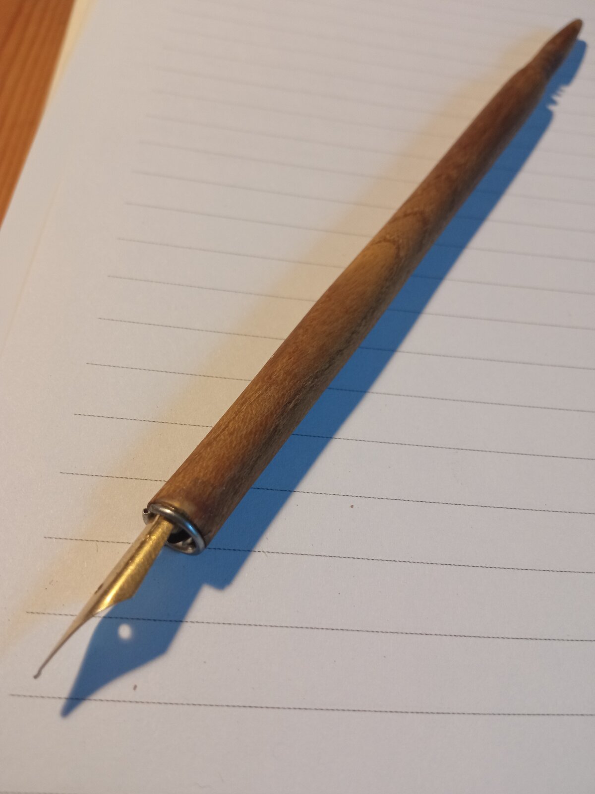

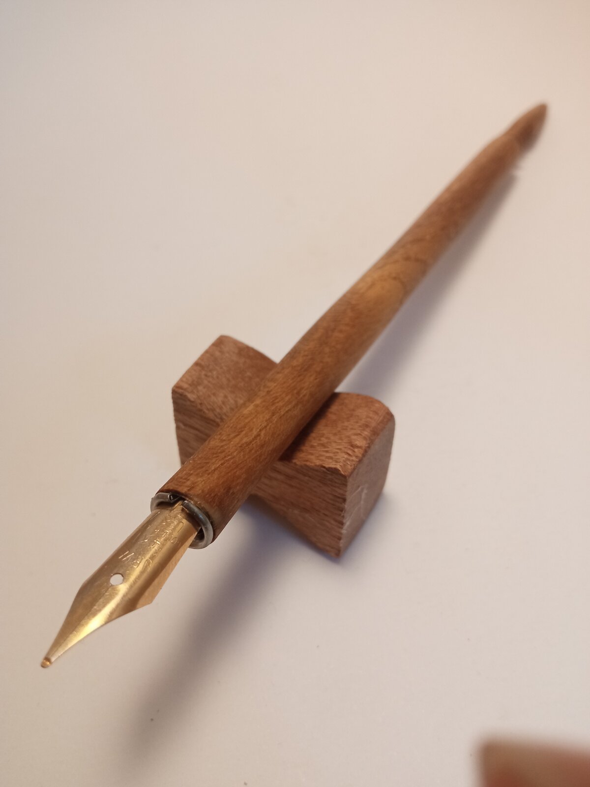

Ok this certainly doesn't qualify for showing off but its an interesting first attempt. I tried to make a dip pen holder for a couple of pen nibs i found at a local hardware shop. After paying a ridiculous amount of money for shipping costs i bought a packet of metal holders that work with 7mm tubes. I used a piece of black mullbery which i had laying around. I discovered later that it wasn't the ideal wood to carve details since it is rather brittle. Anyway this is the mulberry dip pen prototype, cheers

Kudos on these. If folks have never attempted these, they have a bit of a learning curve for the added length. I have turned only a few, but it was a fun. You did very well. Thanks for sharing.

Try to lower the weight on the back end. Calligraphers like light weight, to heavy (by grams) can make the really flexible nibs difficult to use. The balance should be in the hand, with the tail lying in the crook between thumb and index acting, a little, like a counter weight.
Doing these can really teach you a light touch. IIRC, the longest one I did was about 12" long and about 1/3 of the tail was under an 1/8". Any chatter, or catch at all, will cause a catastrophic failure. Keep the pampers handy. LOL
A good standard length, is about 8". You should check out Yoke Pen Company. Chris is consider the OG of the holder makers. He is always open to advise makers, and his videos are a superb resource.
Keep in mind, calligraphy holders is a whole new rabbit hole to fly down. You been warned.;)
