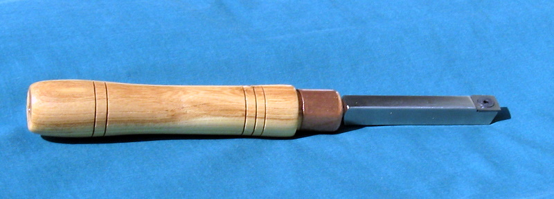

Perfect Rick, thanks so much! How do you like the smaller handle portion at the end? If you were about to DIY, would you add the bit at the end? I like that look but kind of wondered about functionality do you find it comfortable?
Again,
Thanks for the pic, MUCH appreciated!

You're welcome. To be honest, I've only used it on small stuff so I haven't even used the smaller back part. It feels good though so I'm sure I'll like it when I turn something larger than a pen.:wink:

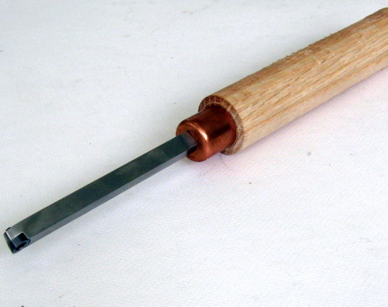

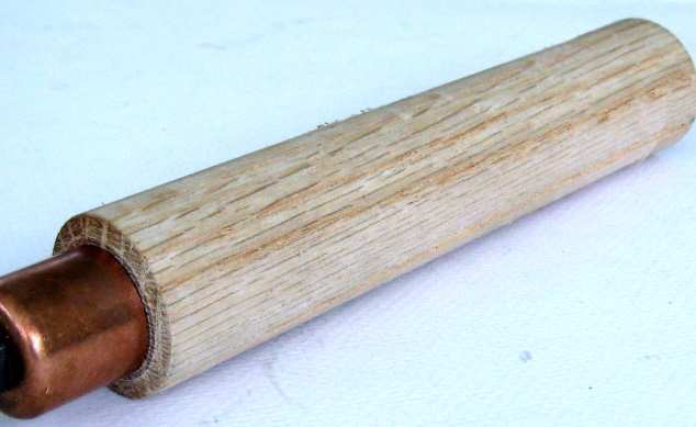

This is a Woodchuck Penpro I had a piece of Oak 1 x 2 cut two pieces 8" long and, glued them together. That gave me a blank to work with. Turn your blank round then, wrap your hand around the blank with your thumb extended. Make a mark on the blank and, start to shape your handle. Of course you will have had to drill for the tongue on the tool at some point prior to shaping it. I don't remember when I did that. Probably, right after the glue dried :confused: Hope this helps. It's just the way I did it. Maybe not the best way and, not as good as Ricks. After sanding I coated it with Deft Poly spray (4 coats)
